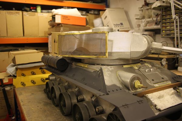

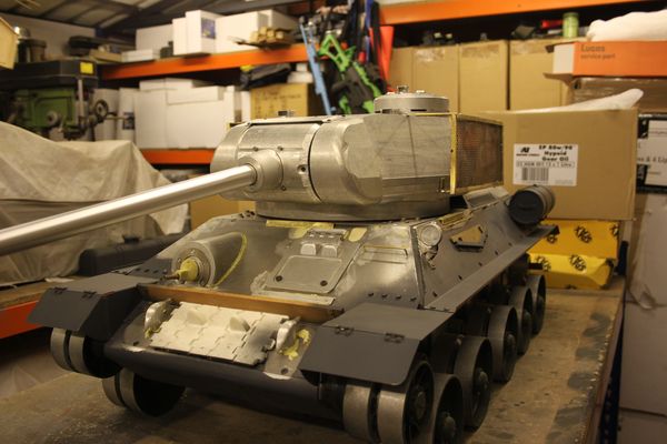

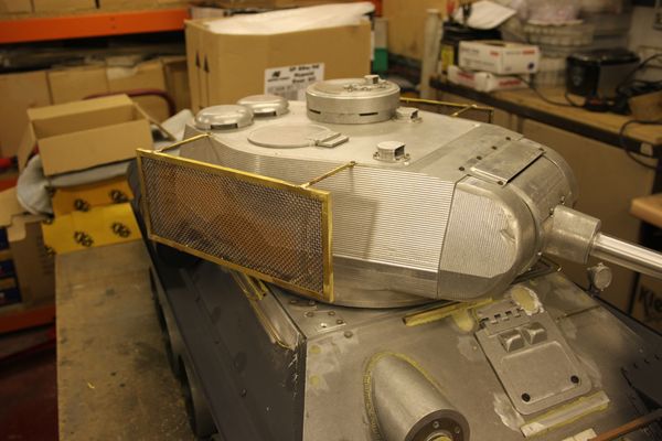

Just decided to do the oplique armour for the T34. Hopefully i can get stuck into mine for a while now. Got tuns of work to do on it Just going through a book i have just got T34 Mythical Weapon. 800Pages
Lee

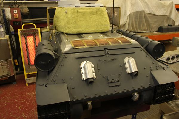

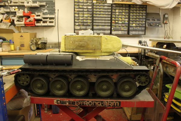

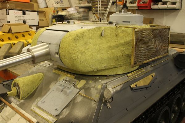

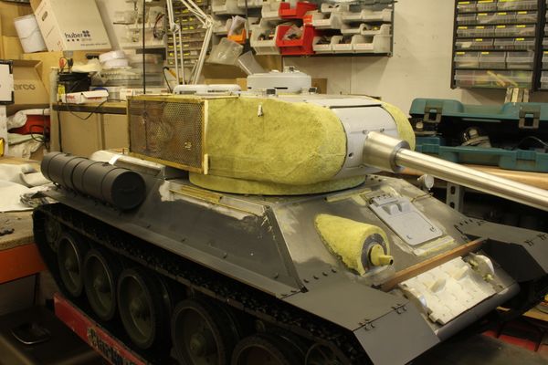

Just done some more work on the Turret and exhaust covers.
Lee
Lee

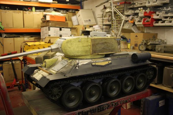

More pics
lee
More pics
lee

Your T34 is looking great.
I like your Turret casting and Mg housing,looks good with your
bed springs for protection.

Thats looking good.Like the turret casting.

Yep like the cast effect looking good.

The cast effect came out well. Use the Red Milliput For the 85 turret you will need at least 4 lots
Put on quite thinly about 2mm thick any thicker and you will loose the shape of the turret. Then you stipple it with a stiff wire brush untill you get the effect. Simples
Lee
Lee
