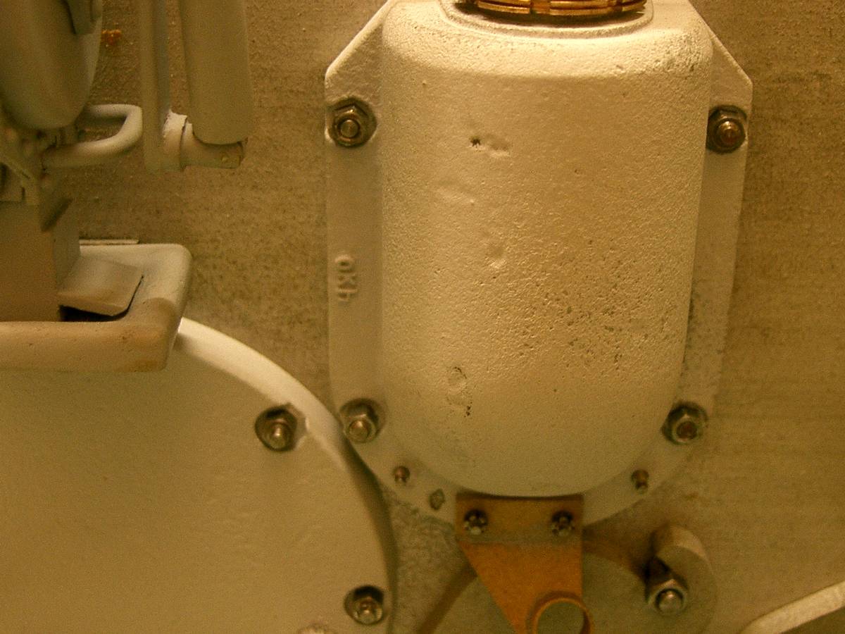

I tried some of that spray filler that was recomended on the forum,but just using a stipling
brush like I did on my MG Housing.
It took a few coats to build it up and get the hang of working quick,its a lot more subtle

Hi Phil,
the best method with the carfiller is to sandblast after applying 2-3 a few coates patches away and repeat the process if you not happy with the result. On the idler I have applied the filler with a putty knife. On the van cover I have only sprayed one coat of filler and you can see, it`s very thin.
Bodo
Bodo

Thanks for the pictures Bodo,your parts are excellent and sand blasting looks to
be the best method,but I havent got any sand blasting equipment,I will have to
look into it.
The photo's are very helpfull because you can really see what can be done with
this product using different techniques
Phil
