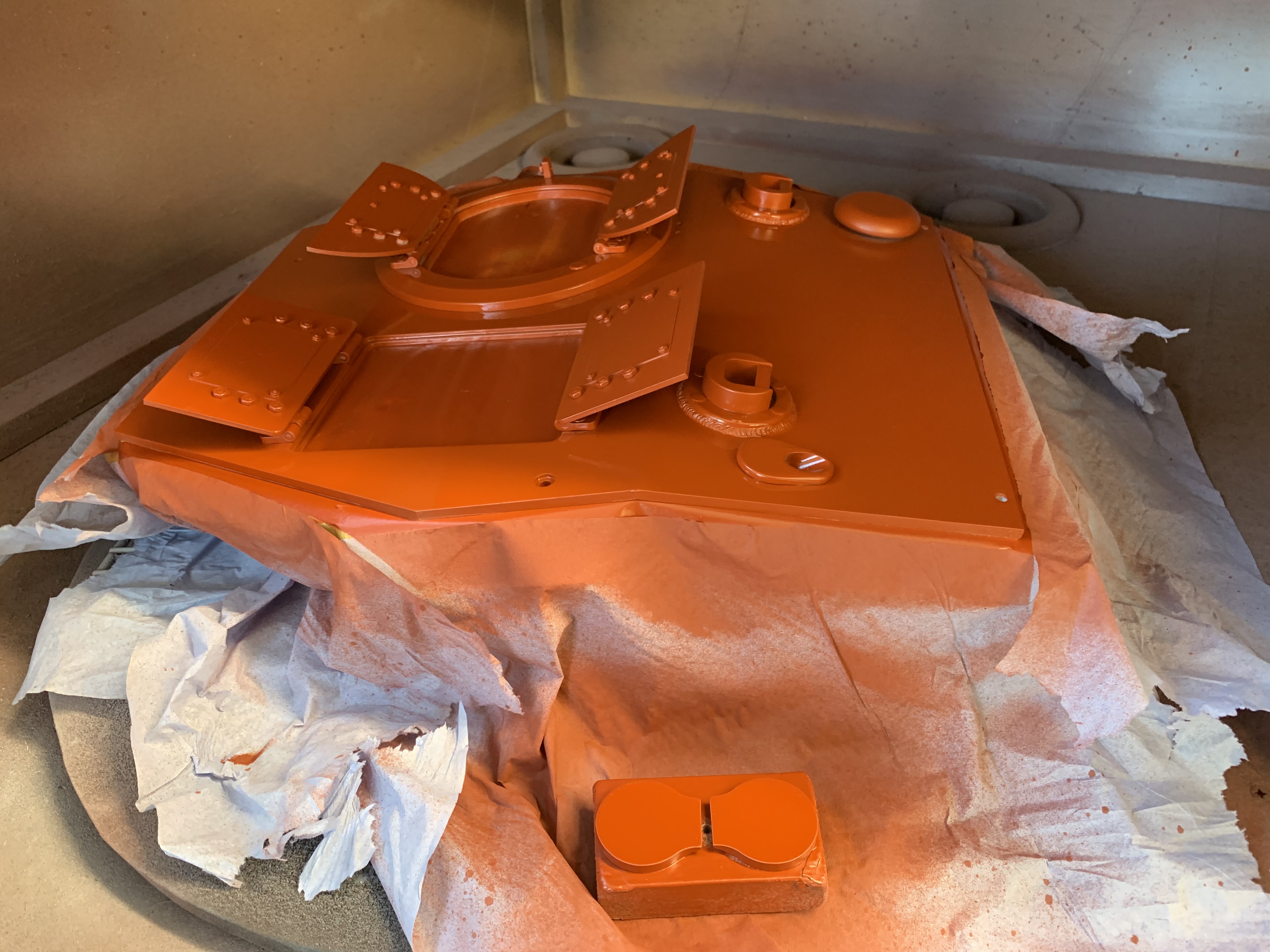

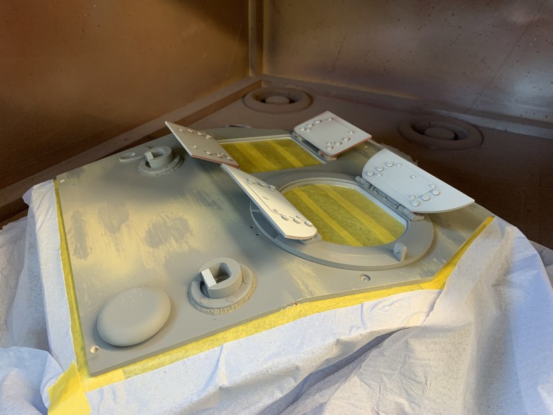

Hi Chris
I quite like using high build primer then dragging a small sponge across it. You can see the effect on the turret roof, this is for large armour plates and gives the look of the drag marks which occur during the manufacturing process. It works especially well on the Tiger deck plates and turret roof. Be advised high build primer dries very quickly so have the sponge ready, I use a small piece of natural sponge as it seems to work better. Do a test on a scrap bit of metal and try to do the drag mark in one smooth motion. Also make sure any marks are irregular as would occur on real plates.

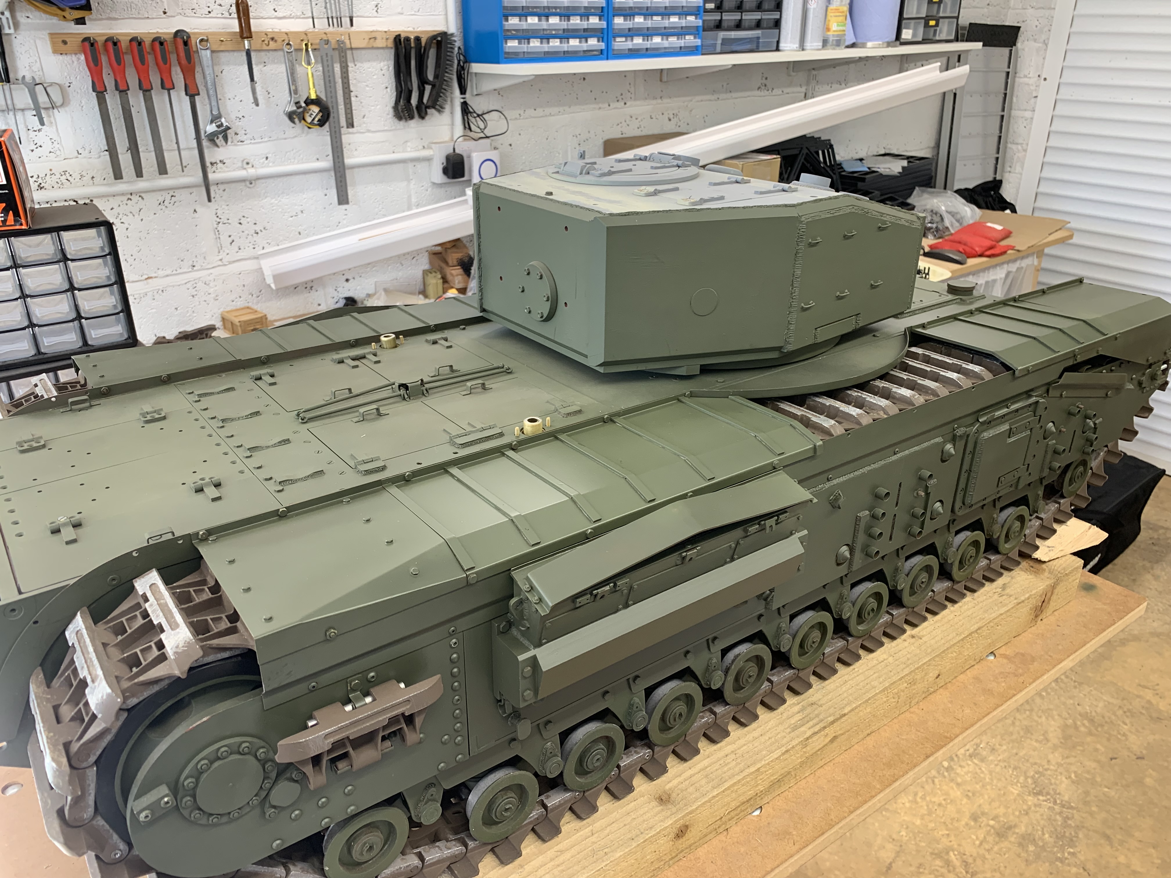

Earlier today I posted 'AVRE tows a 17PDR'. While this worked very well I did have a problem with the rear section of mudguard. The tracks were catching it and have distorted both mudguards. At first I thought it was the rows of nuts and bolts I have added but the paint on the underside of those is untouched. The witness marks are on the rear edge of the mudguard so it looks like the front edge of the spud is colliding with the mudguard.
It has been at least 3 months since I last ran the AVRE so I am hoping it was just a couple of tight track pins causing the track to ride up as it crested the rear sprocket.
I did a trial fit of the rear curved mudguard as fitting this may solve the track riding up but there is a problem there too. The tracks are so close to the hull there is very little room with the EX303 and the mudguard fitted for the tracks to pass by. The only solution I can see at the moment is to remove part of the flat inner section of the mudguard EX0318M leaving just a 10mm arc for strength.
Has anybody else noticed this and how did you get round it.
Gary

I've noticed something similar on my AVRE. From memory, there's a void in front of the sprocket. The track seems to cling to the sprocket and be pushed down into this void. This inturn causes the following links to ride up off the sprocket and clash with the mudguard. We were looking at it at one of the shows last year and I ended up taking most of the mudguards off to check clearances of the hull and mudguard fasteners.

Clearance over the sprocket seems to have been a problem on the real thing aswell. When I was researching Churchill it looked to me that the top of the mudguards was banana shaped ie. they curved up at either end over the sprocket and idler. The amount of curvature seems to have varried with different versions - something to investigate?

Nice to hear from you, hope you are keeping well. I jacked the tank up on the trolley and ran the tracks unloaded, they ran well and didn't foul the mudguards but there was only about 3-4mm clearance. I will try running it outside loaded up and see if the problem replicates itself. It may only happen with a load on the tracks. In any event this may become a problem in muddy/long grass conditions as debris accumulates under the mudguards.

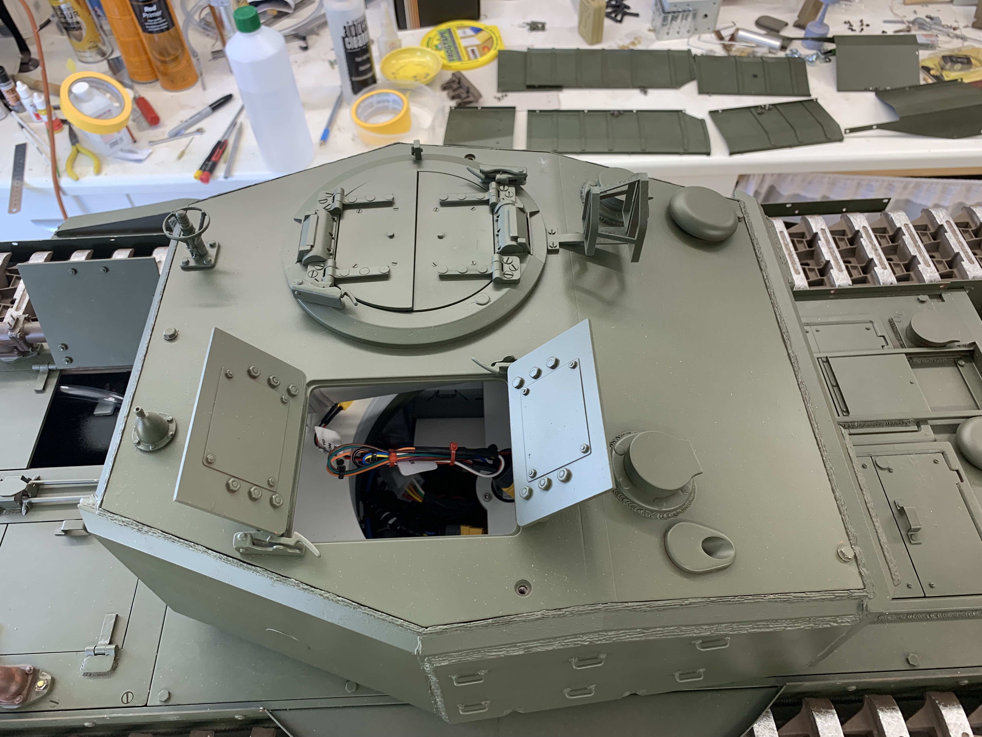

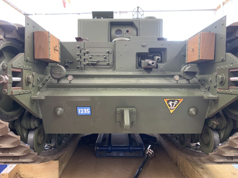

On a positive note I have completed painting the turret roof and have started the detailing. I know the cupola is wrong for an AVRE but I intend to make a new one with periscopes once the Churchill is completed and the Bailey Bridge is built so I get my workspace back.
The 79th Armoured Division insignia and 42nd Assault Brigade markings have been added and some numbering stencils ordered so I can add T68738 C to the mid section.
Gary
Texturing with high build primer and etch primer
Red oxide undercoat
Red oxide undercoat
