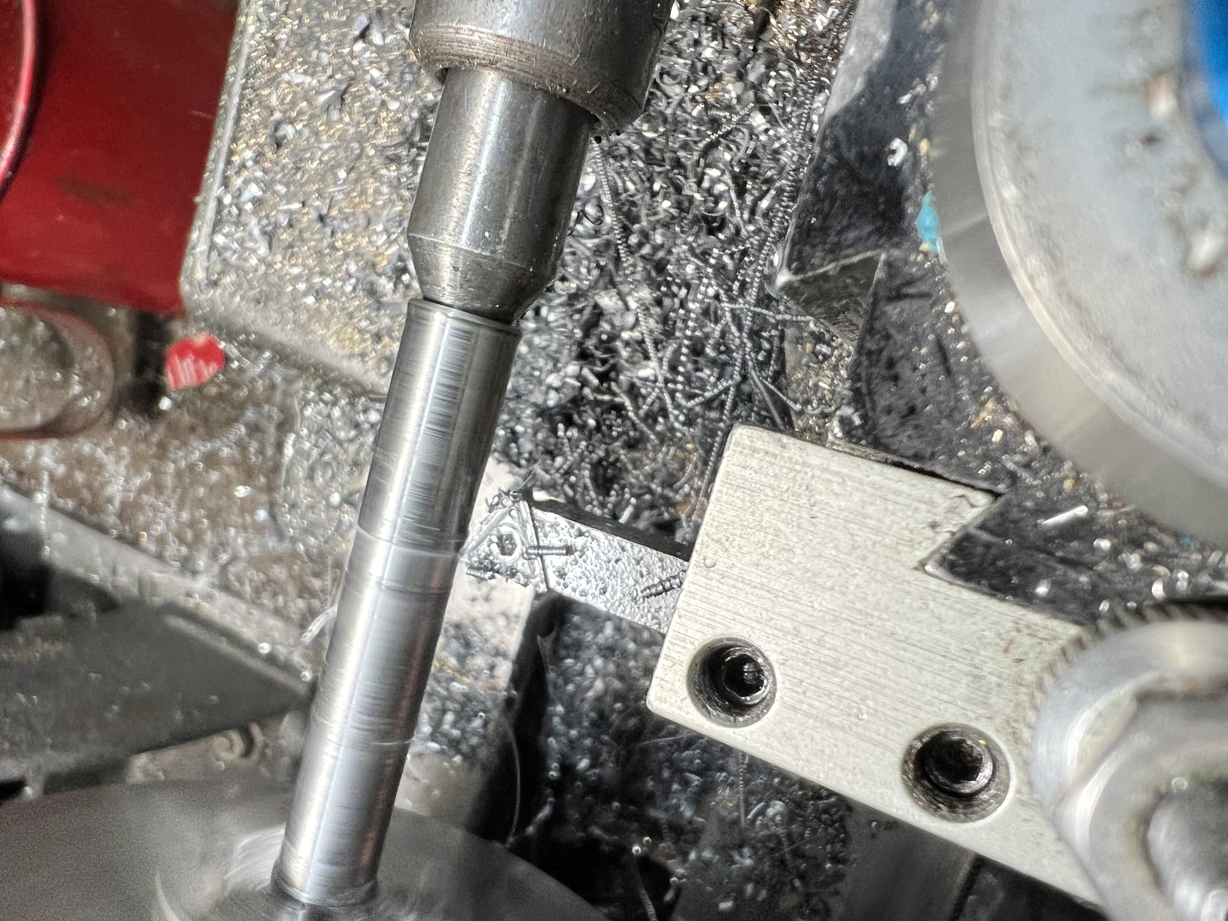

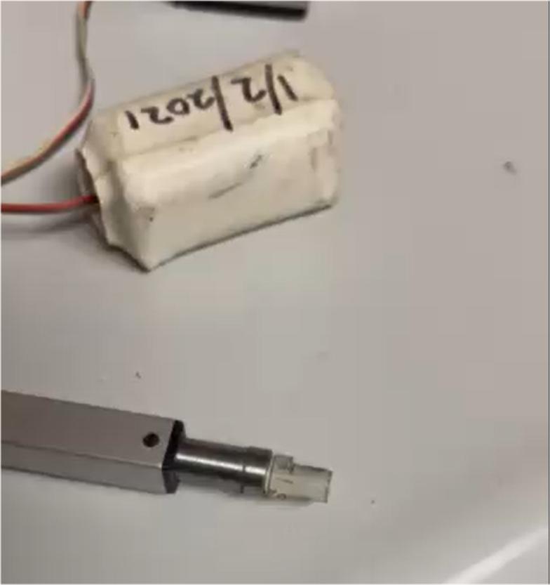

After wrangling this beast of a model I was able to remove the linear steering servo and examine it.
After careful consideration and detailed examination I came to the conclusion: "It's broken Jim".
Yes indeed the aluminum arm busted clean off where the connector is screwed into the end.
I decided I'll make a new one. From steel.
- chopped off length of 10mm shaft rod
- Trimmed and faced ends of shaft rod length
- bored out rod to 6.85mm
- threaded ends to 8mm x 1.25
- reduced outer diameter to 9mm leaving 5+mm on the outer end at 10mm.
- polished arm body
- Installed new arm in servo and test
