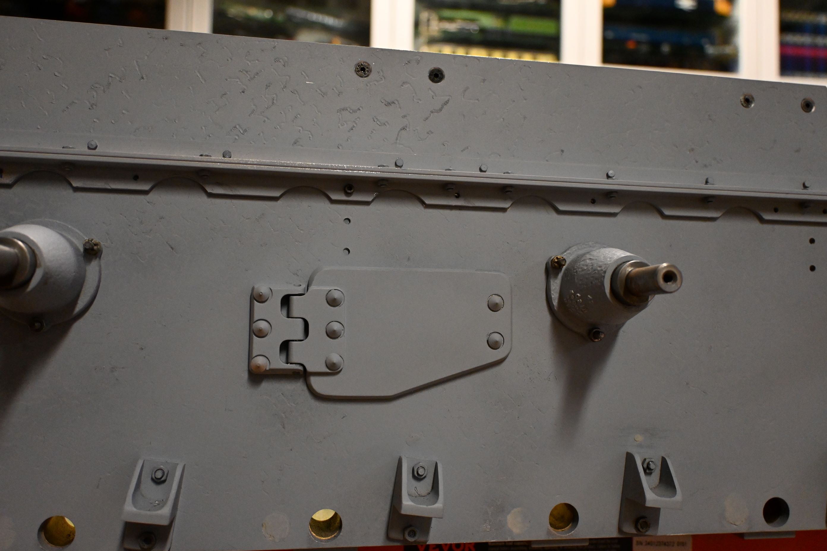

Some more progress with Panzer III.
Made some covers for base and bracket detail to hull brackets.
Video coming soon.
Video coming soon.

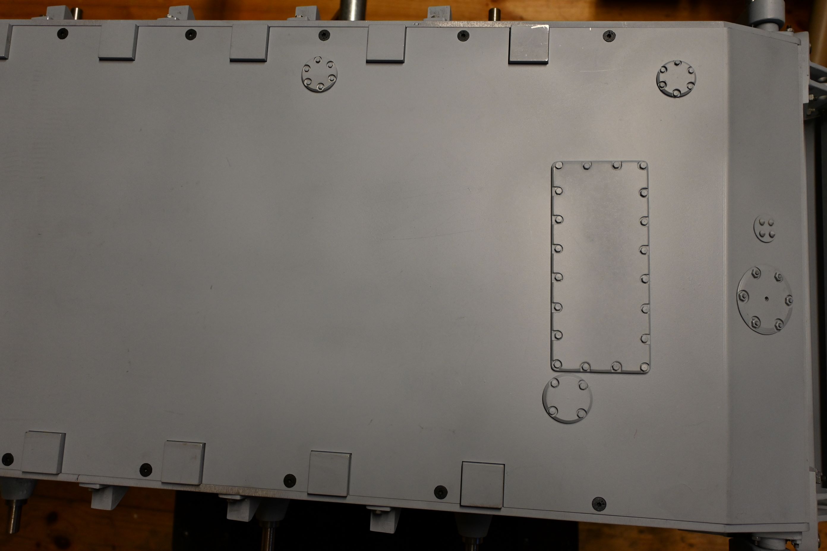

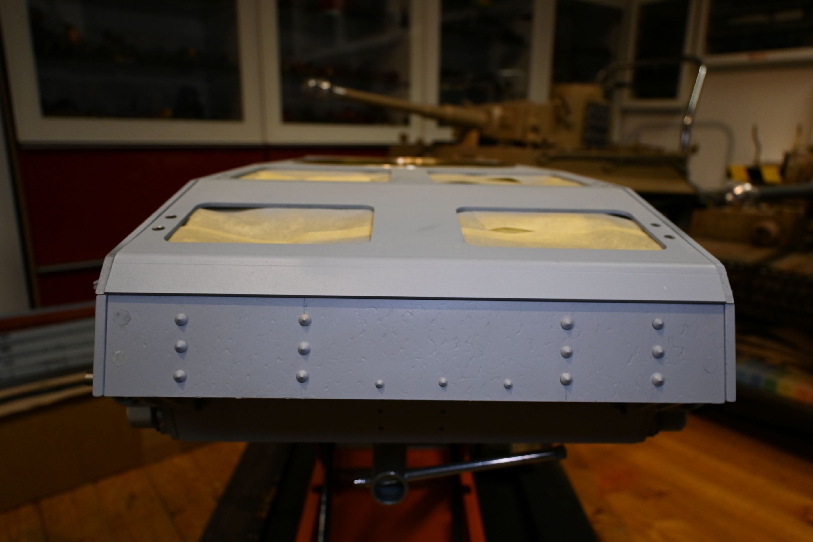

I have fitted a full length floor to the hull. Also a division/firewall which will give better support under the turret. This will allow placement of batteries and electronics over the torsion bar suspension. Not sure if kit came with floor or battery tray. This one had none but prefer to make my own anyway.
Next adding front hatch hinges, some weld lines, MG ball mount and protection strip for driver. Added the holes for tapered bolts on milling machine.
Started tidying up screw holes filling with Miliput. Filled holes on rear deck as making new hinges and hatch supports.
I will have some video soon.
