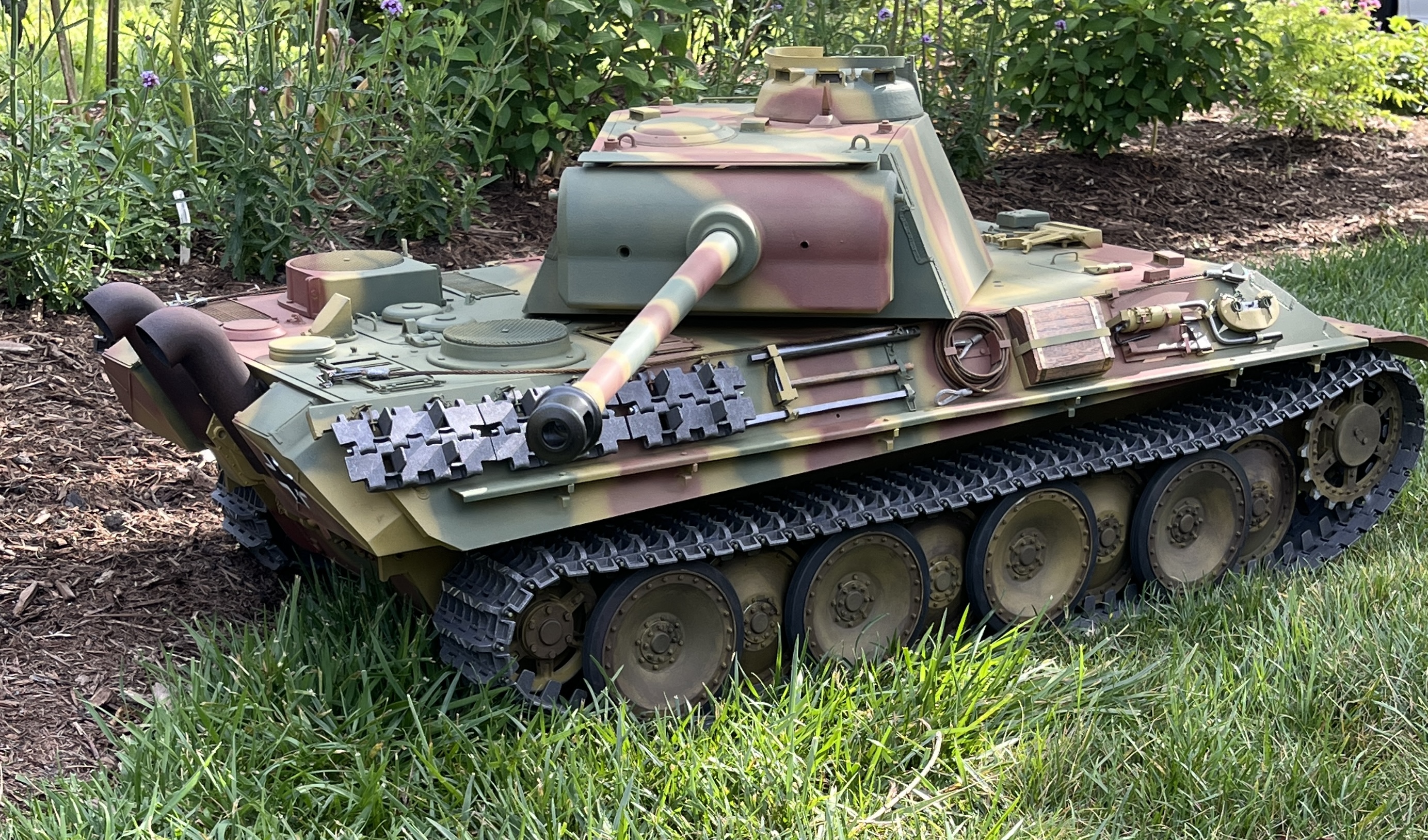

- Posts: 34
- Joined: Thu May 04, 2023 12:20 pm
- Location: Virginia Beach, Virginia
- Been liked: 29 times
Re: 2006 Panther G finally coming out of the dark #39
Hello,
Happy to add an additional Panther to the group. Weathering has been my most intimidating factor, I am nervous about adding details that are not up to the standards I see here on the Forum. The information and pictures here give me the confidence to take on the task and jump right in. So thank you all for your talent and advice.
I am anxiously awaiting a few parts from Kian & Monique to finish the build. Then onto the next build.
Dan
