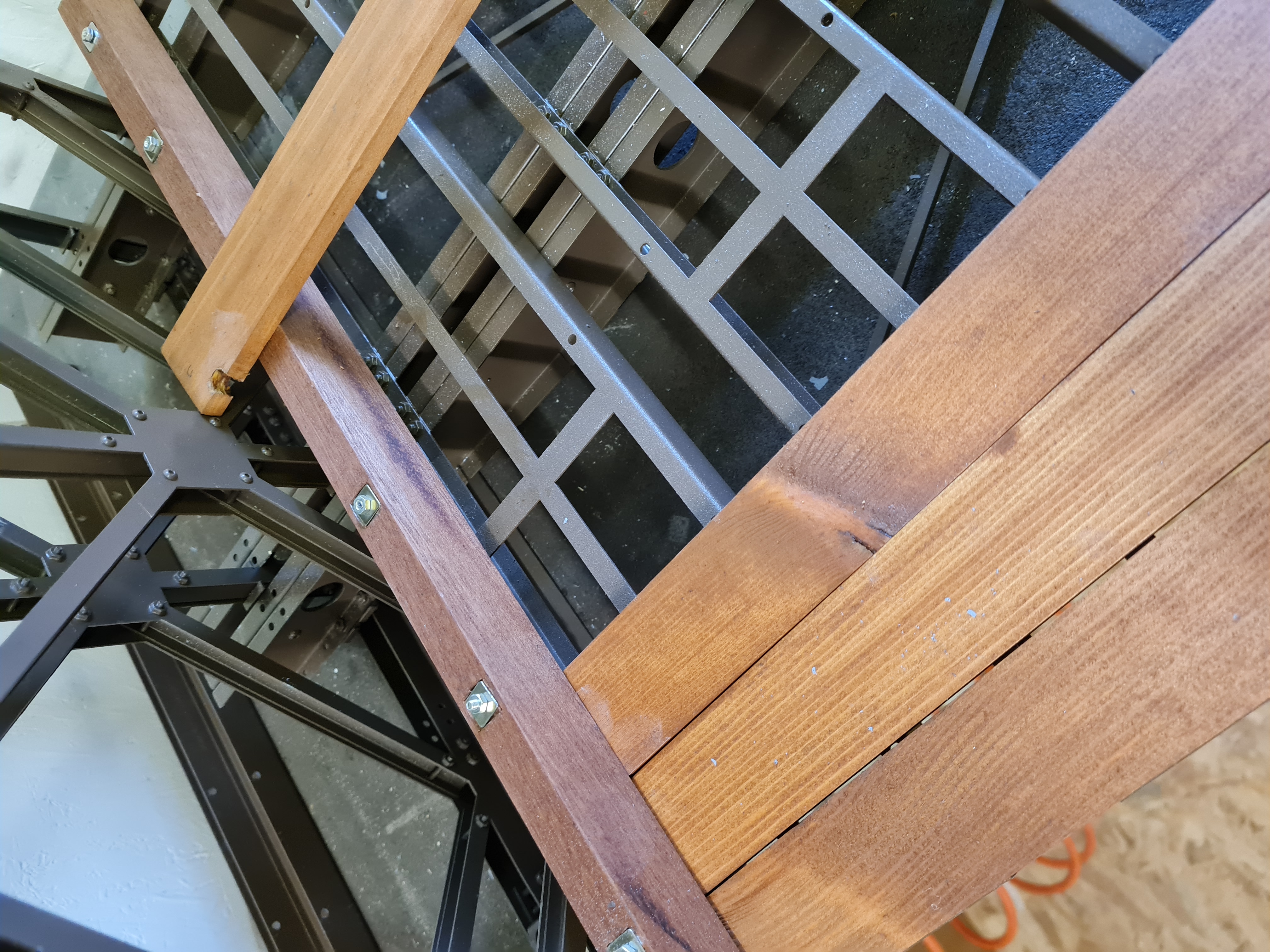

Hi guys

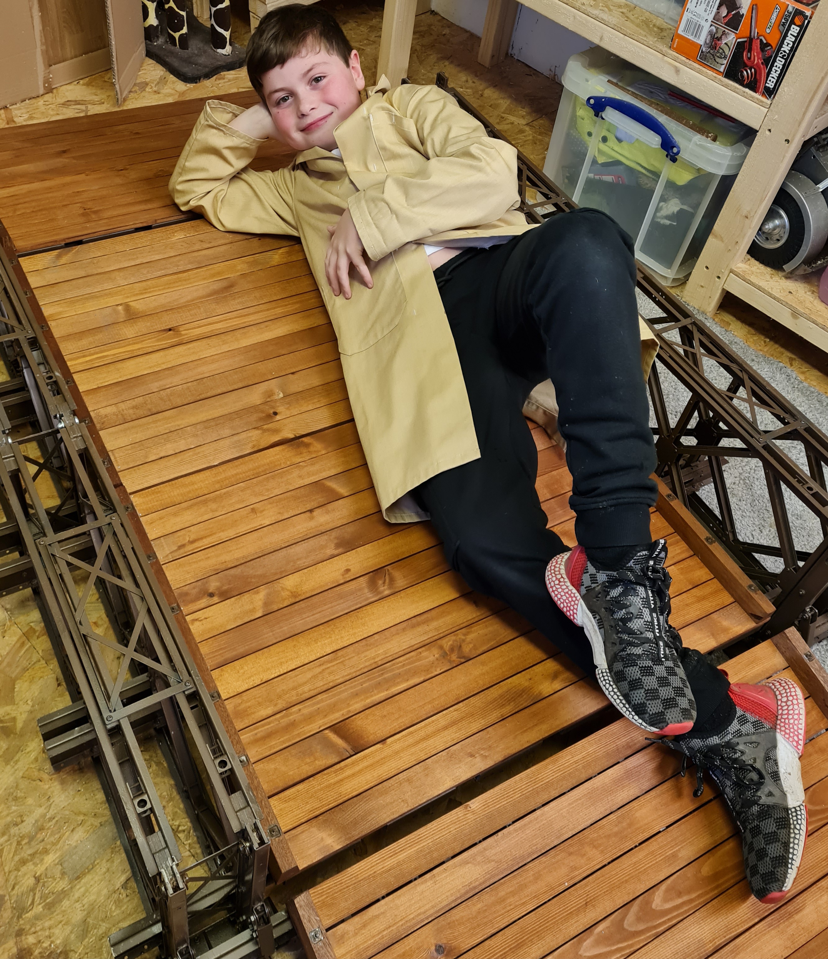

Well we got back into the workshop again today and have finished span two.

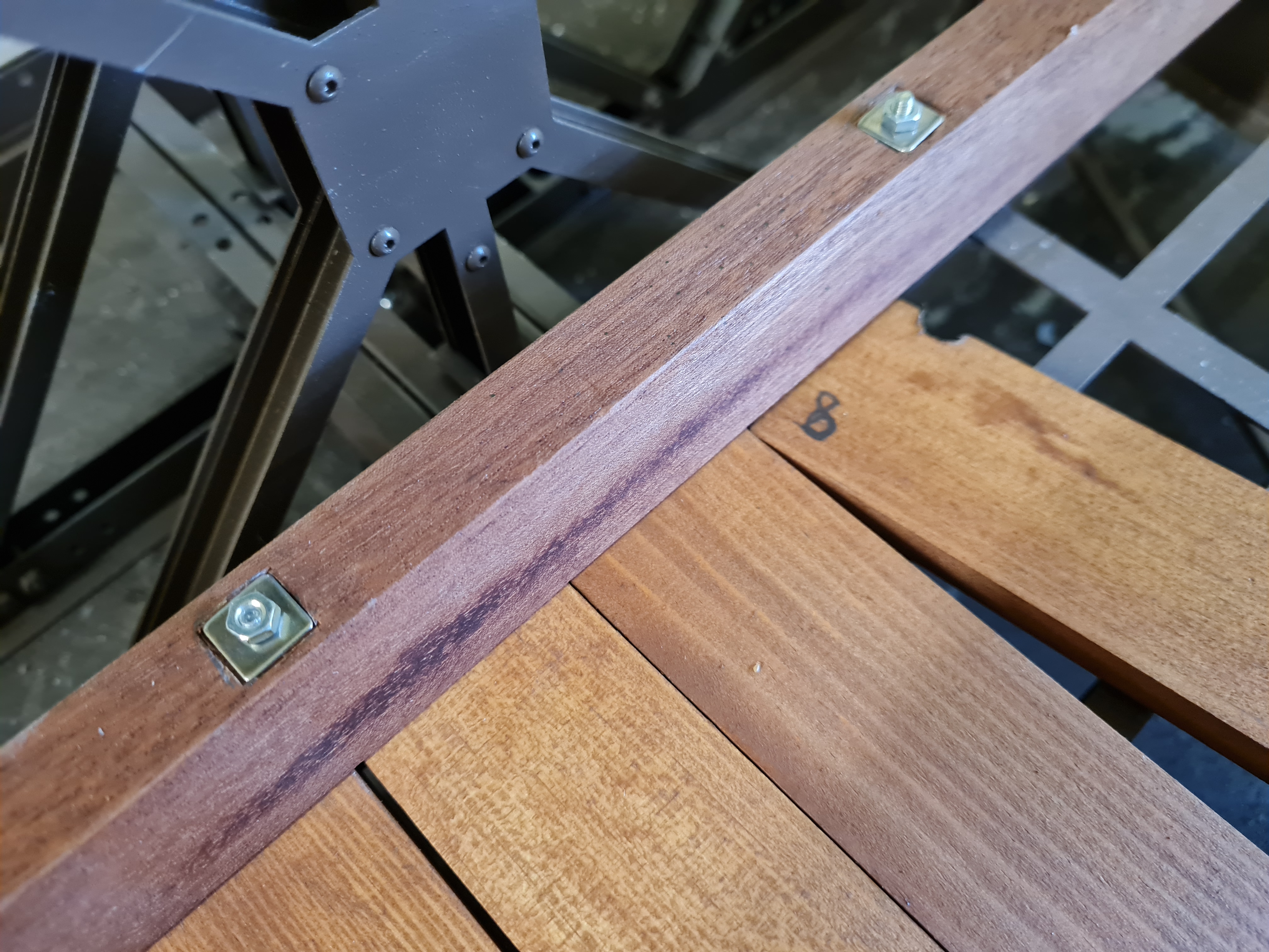

What I did find to make thing's easy was to fit the ribands loosely and slide the planking under this has made life so much easier on the build.

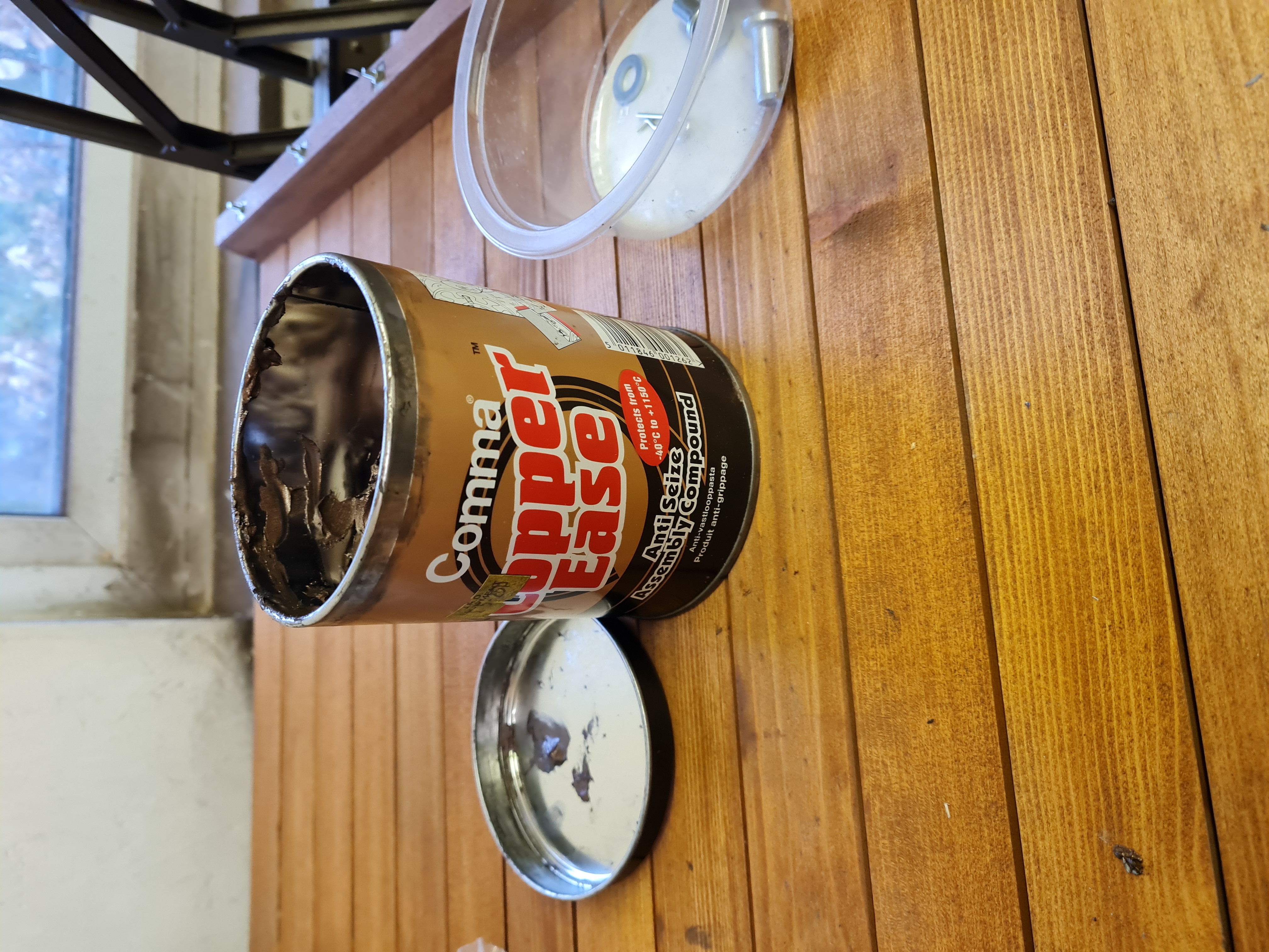

I also used a Liberal amount of copper slip on the fittings of the end posts to aid fitting and help prevent rust when the bridge is used outside..
I hope this is of help Garry when you start your build.
Next job to trim the planking for the ramps seal stain assemble and put every together.
Take care and keep safe
Steve and Tiny

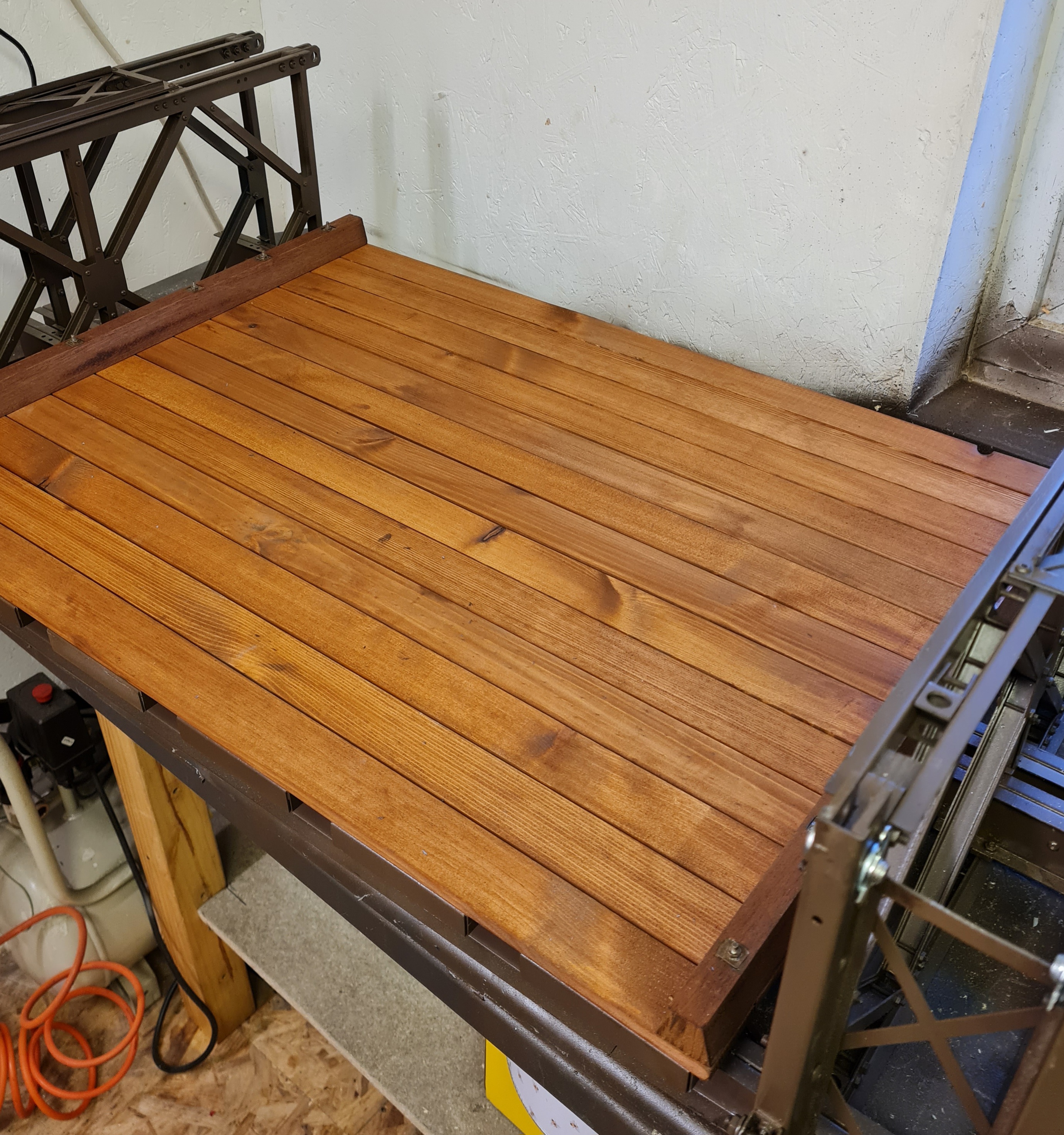

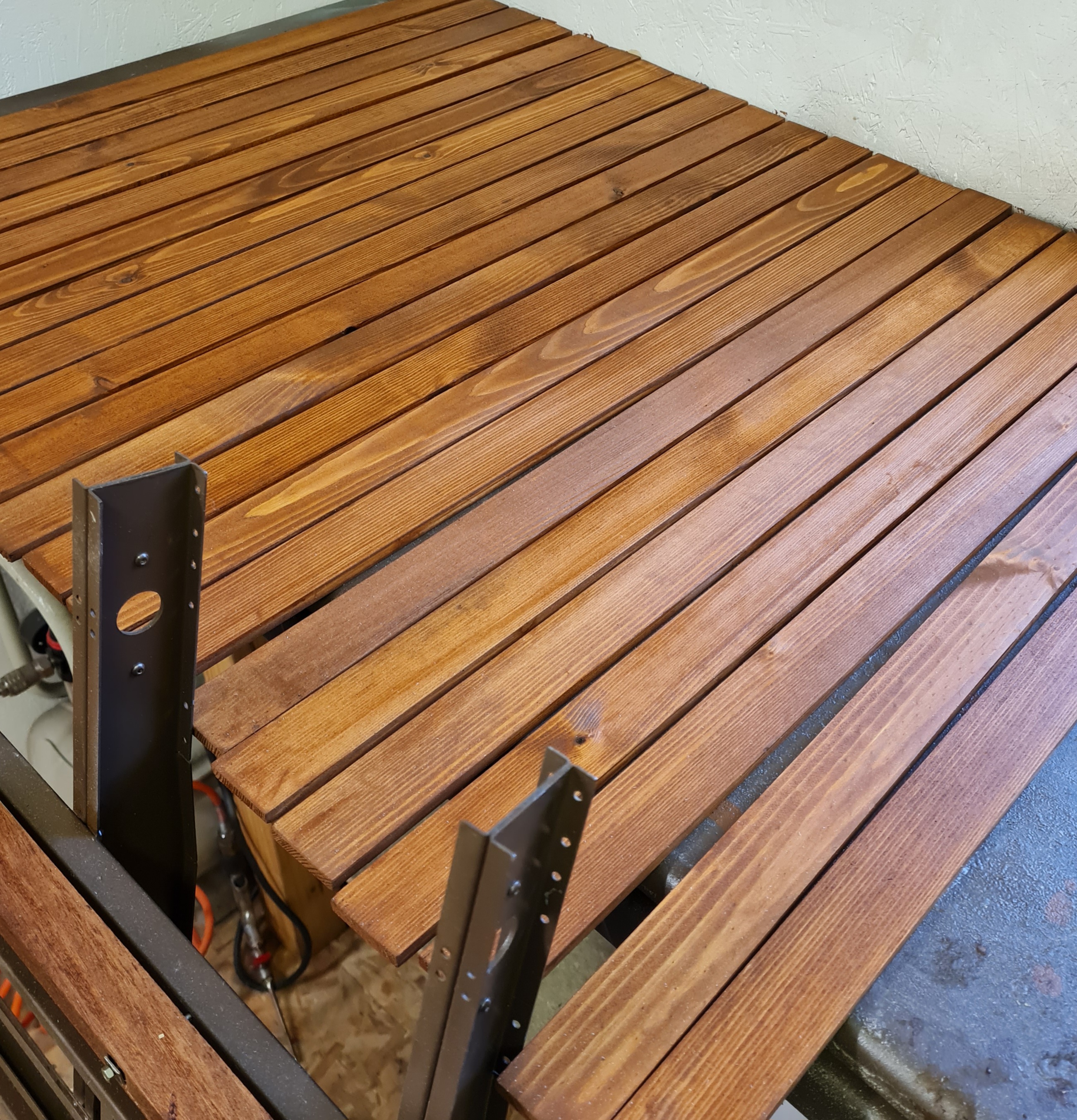

Hi all
We got back into the workshop again today to finish the assembly of the ramps
So now all the pieces are made its time to fit everything together.
This we will do over the weekend as tomorrow I have a shopping trip into town no fun there then
Take care all and keep safe
Steve and Tiny

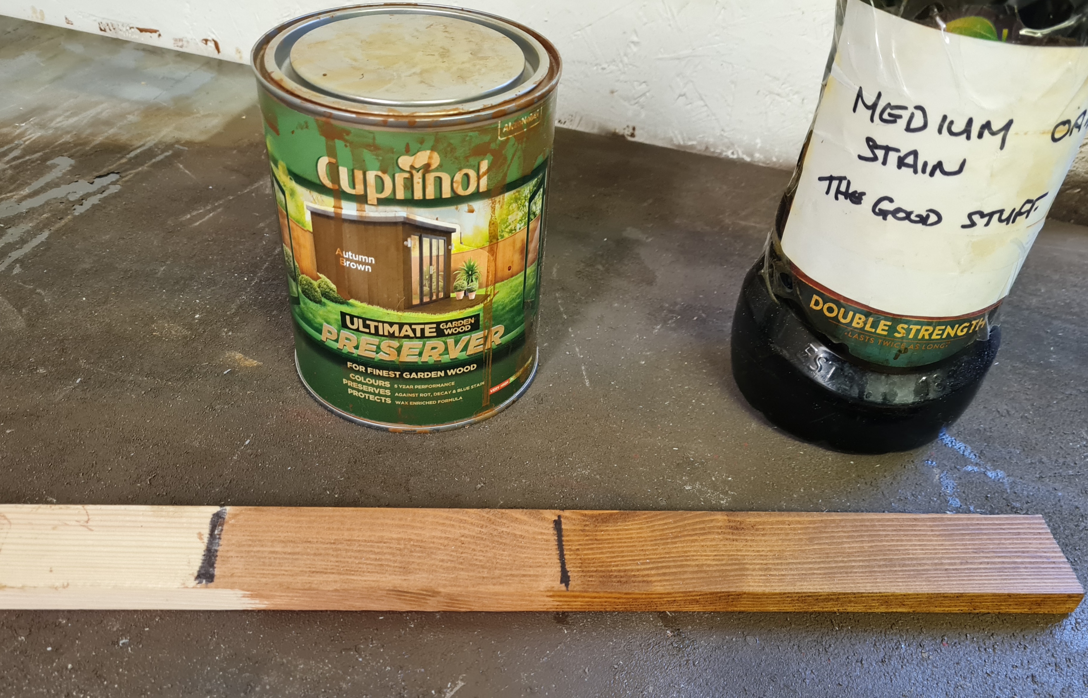

- Just for interest this is how I made the planking.
I bought red wood strips cut and planned to size.
Then useing a rubber( a bit of old rag ) gave the planks a coat of cuprniol all round to seal the wood.
Once dry I coated all the planks with medium oak stain.
The stain I use is solvent based this gives everything the beep chestnut colour you see.
I hope this information is of use to some of you guys.

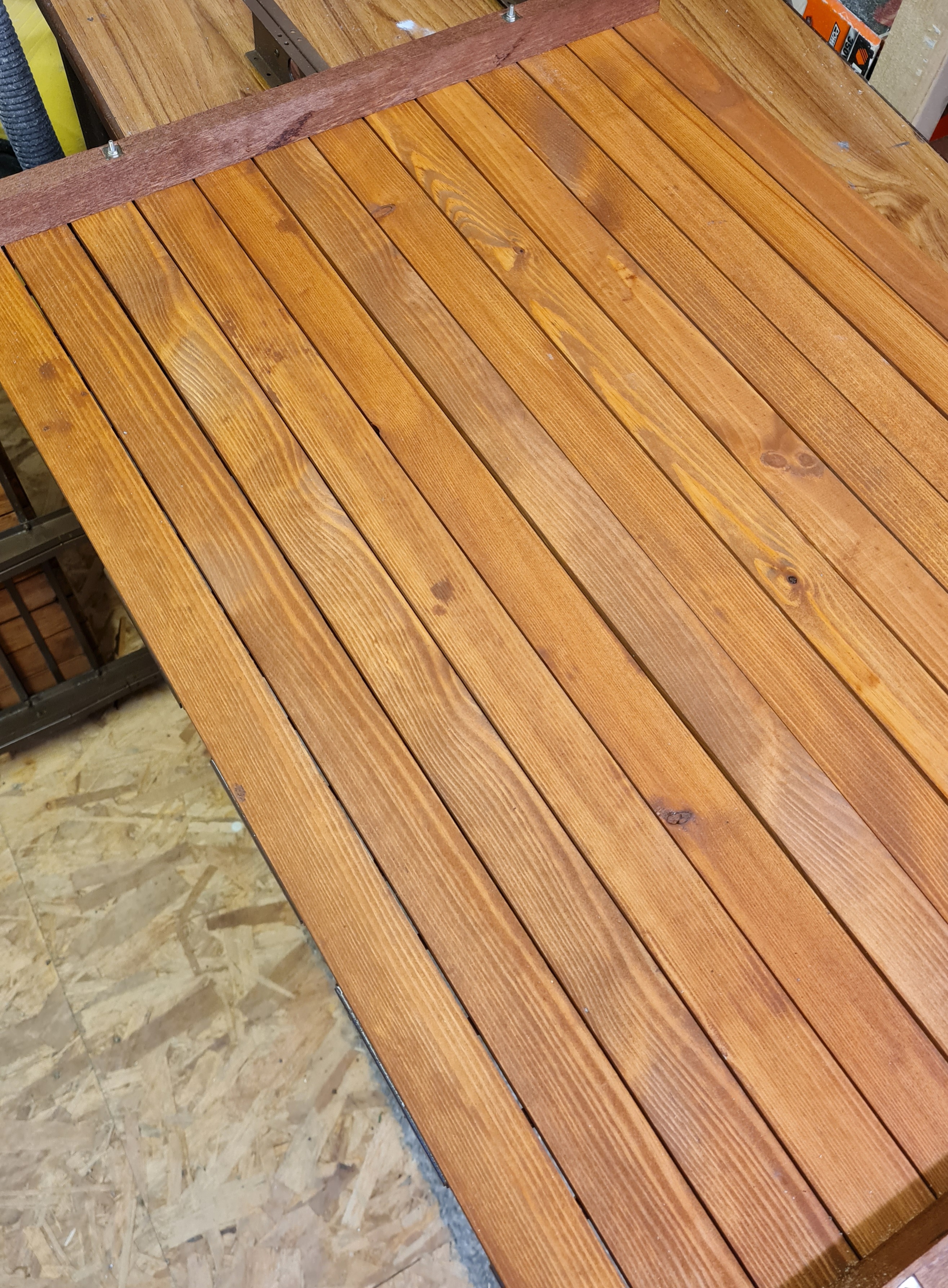

Hi guys

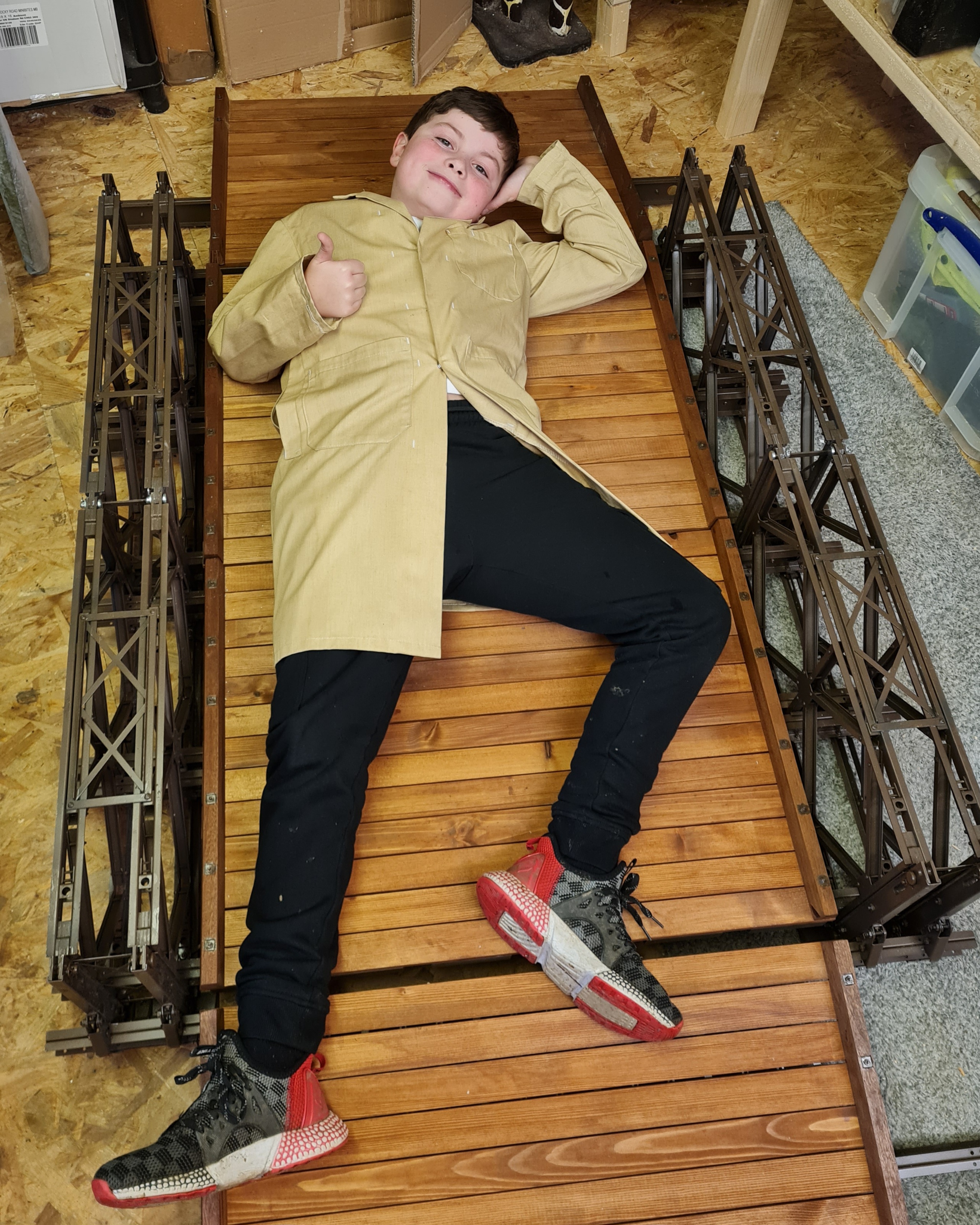

Well at least the bridge is done.
Everything fits as is should the only thing to do new is to paint the fasteners although I may change these at a latter date for nuts and bolts.
I did make one big mistake right at the start and that was I should have orderd a 3 or 4 span that would have done this fantastic model even more justice.
