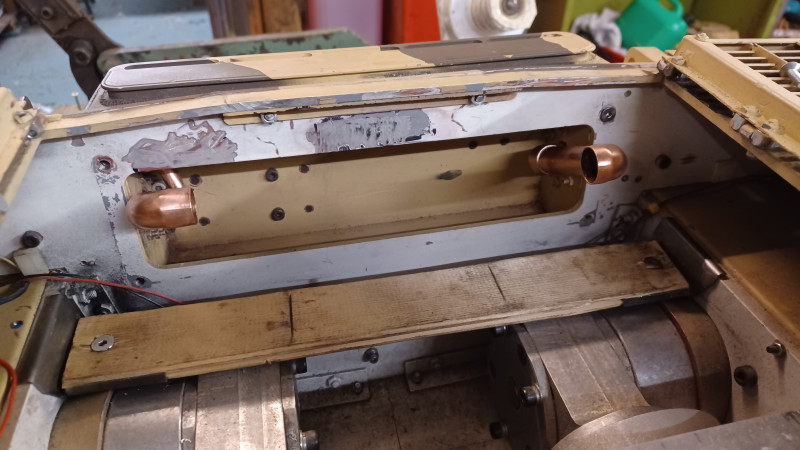

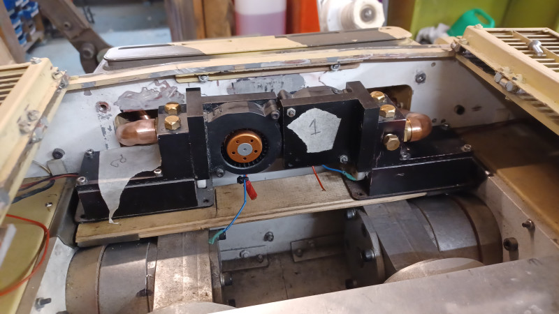

Smoke generators As the previous owner had used plastic pipe and some copper. It needed replacing , also I need to turn the smoke generators round 90° to make room to fit the engine. made a manifold to feed the main exhaust and the donkey engine exhaust. This involved putting a small baffle inside to push the smoke towards The small pipe that part is experimental
