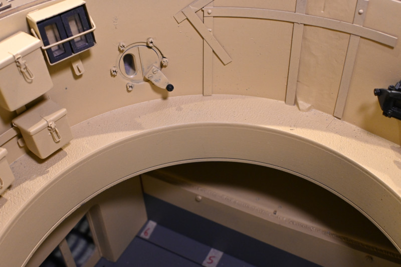

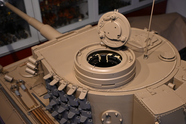

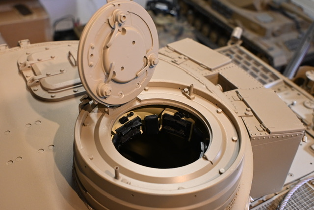

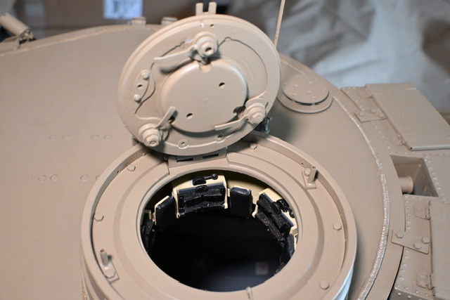

I have added more details to the early Tiger 1.
Modified the kit cupola. new cupola roof was a challenge to my small lathe. Added many other details. Currently lid head pad is aluminium until I find a piece of rubber to fit
modified the solid pistol port to make functional.
Made a new fan unit from parts of kit fan.
