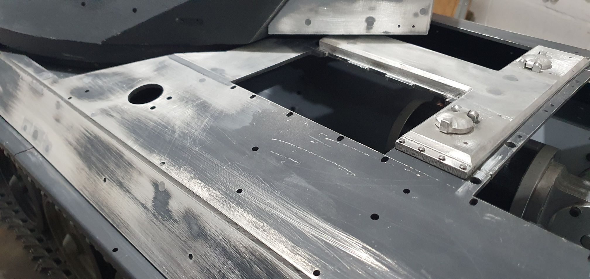

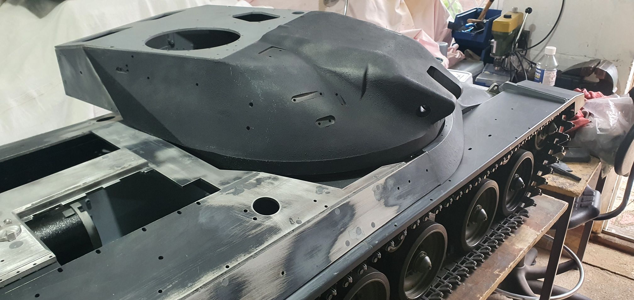

When my rear deck turned up it had a shallow bend along the red line as in the first picture, it didn't matter so much because the Tee piece cut out mod would take care of it. But the saw cuts arrowed, needed filling in with something. Hence the thin plate.
The second picture shows the Tee piece in place with a sandwich plate to a) raise it a little b) allows the flattening of the deck between the angled sides. This allows the deck covers to appear to lie flat as on the original. It's a bit nit picking, but I felt it important to emphasize the flatness of the eight deck covers as opposed to the hump backed four at the rear.
Arrowed is the filler plate to close the saw gap both sides. Not seen at the other end as it is covered by the Tee cross plate. If you have a very fine cut you may not need or want it.

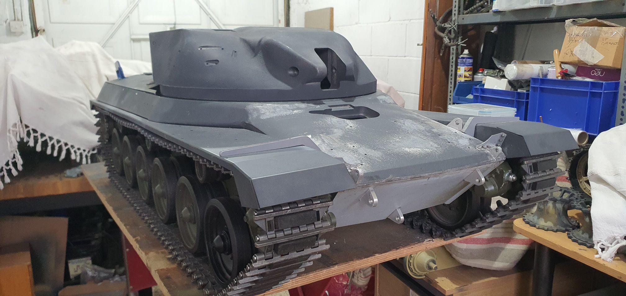

I've not done anything for a few weeks due to other hobbies taking up my time, and Ive been putting of making a bracket to support the turret due to the only piece of metal that was suitable was steel ( 1st generation tiger deck support) this required some serious work with the hacksaw!

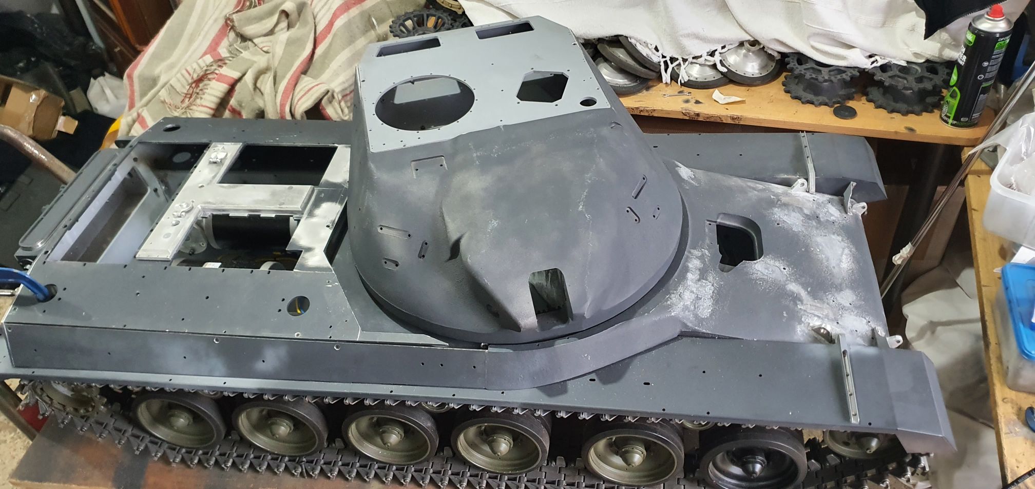

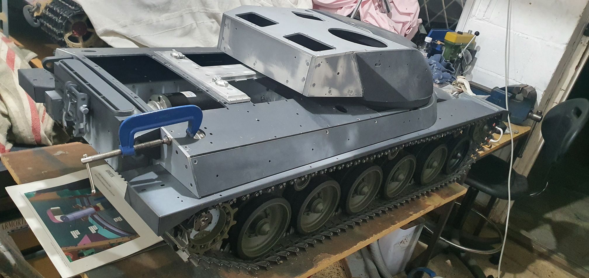

T piece has now been fixed in place permanently, brackets made and fitted to secure.

This was the easiest option, now I can move on with something else. As you mentioned I can remove the turret if needed.
now I need to find the enthusiasm to build the grills.
