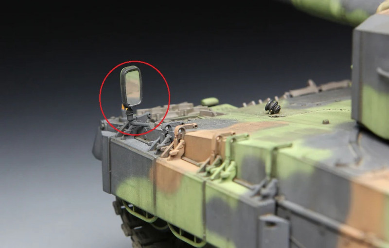

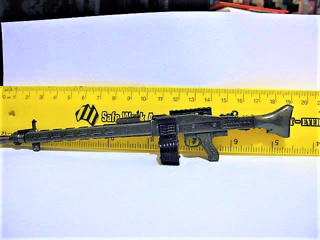

Hi Chang,Chang wrote: ↑Thu Oct 03, 2024 11:18 amThis is the most detailed upgrading modelling I've ever seen. Well done Günter .
I always am thinking of adding two rear sight mirrors , a MG 3 machine gun on the turret's roof , and two correct-shape towing cables. Have you thought them too?
Lerh Chang
I am still not certain if I place the machine gun to the loaders hatch. I plan to rework the look of towing cables however, these will then not be able to tow the tank. The mirrors will be added, at least in fold down position.
Kind regards
