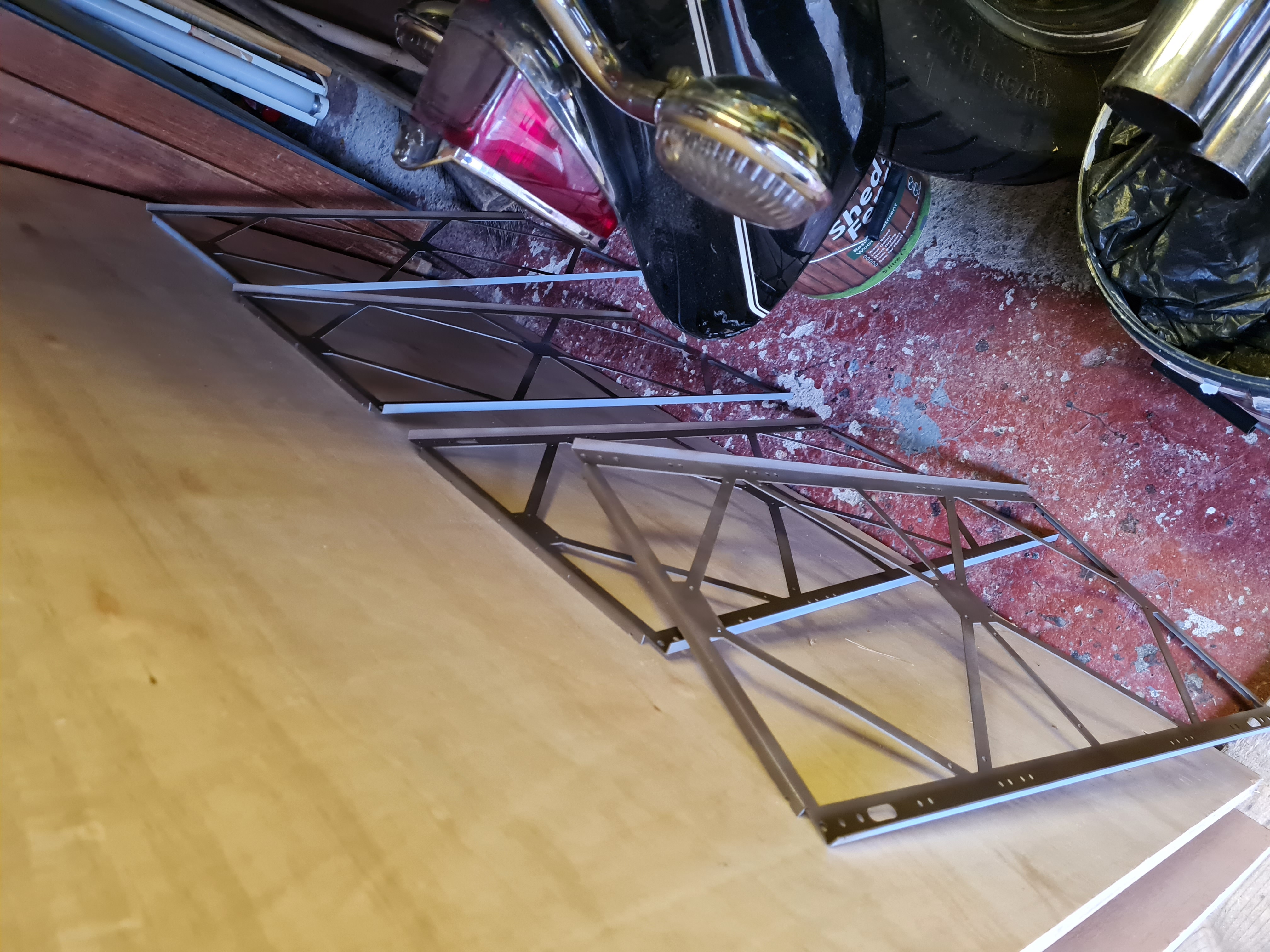

Over the past few weeks tiny and myself have been working on a new workshop to give us more room to work.
Its not quite finished yet but has been well and truly Christened.
Well we managed to get back into the workshop over the weekend and today after the school holidays kids back to school tomorrow and family up from England for a holiday and now its back to normal.
Tiny and I finally got the last of the undercoating done.
The paint for the bridge arrived quite quickly after ordering.
We decided to paint all the parts prior to assembly this is to give additional protection from the elements.
The paint comes in matt or satin after chatting with Keith from paints R us he told me that the matt paint marks very easily so we decided to go with the satin option.
Once all the sections are made and painted we will give them a coat of matt varnish to tone it down.

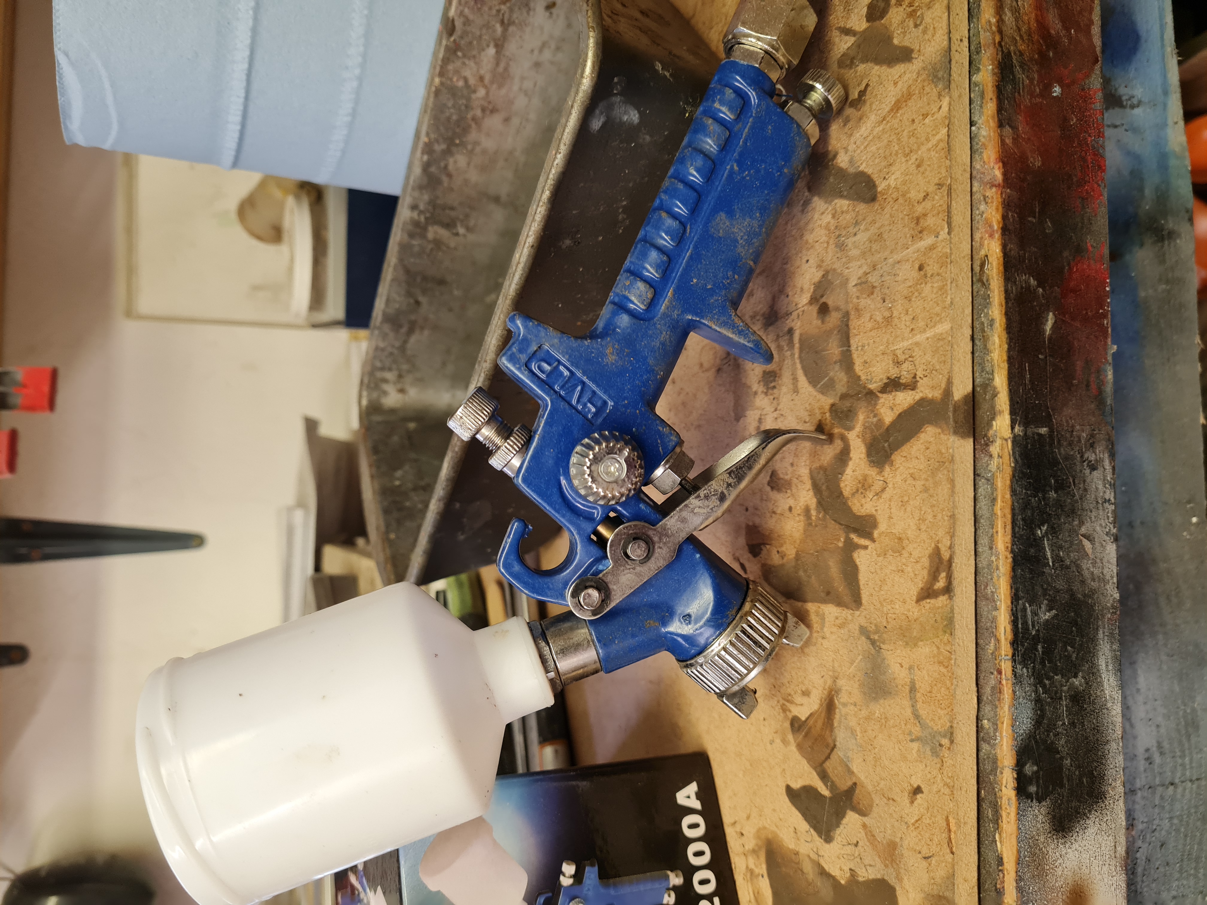

We are using our old and trusted mini air gun I knocked down the paint to a 10 parts paint to 4 parts thinners it's a lot more economical than using a touch up gun and a 10 to 1 mix as recommended.
There is now part painted parts all over the workshop.
Hopefully we will get back to it tomorrow after school.
Thats it for now.
Take care and keep safe .
Steve and luke

I will post a photo of my compressor for you tonight when I get home my old devilbliss gave up the ghost when the bearing collapsed.
I was talking to Phil Woollard a wee while ago and he recommended the one I am using now you don't hear it running its so quite.
I also have 500 ltr compressor for big jobs but thats overkill lol.

for those who have not a compressor suitable for paint gun (not airbrush) you also have the possibility to use rattle can
Cf post from Laurent (viewtopic.php?t=8072)
Color / qulity of paint is very good.
Also, beware not to overtighten the screws for holding all the small brackets in between the side panels. Those brackets are"soft" and the can be crusehed easily.
I have made "some" spacer from brass tube (3*6) to avoid this.
Didier
Great job you have done.
Didier

for information, if someone wants to go on with the spacers, there are of 3 different length, depending on location / number of parts to be held (do not remind the length / number for each)
i used 3*6 brass tube which is a bit thicker than the standard 3*5, and needed afterwards to re-drill them as inner diameter is closer to 2.8 than 3 !
the picture shows the amount needed for 1 span
as for paint i used that ref : mocca (188) 327173
(just google it with spray can you will reach the right info)
May be not perfect SCC2, but close enough, not too expensive, and resistant to UV and scratches !
and seems those are available in the UK.
Didier
