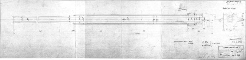

Thanks for posting that, most interesting. I am in the VERY early stages of starting the current Early Variant T1 and starting with a gun upgrade. I basically want to have a heavier and more balanced gun and a more prototypical interior configuration. So the whole assembly is being remade in steel. I am gathering materials and currently 'occasionally' getting some time to start roughing out the muzzle brake and breech. Looking at your '88', are your recoil recuperators / dampers functional? I was thinking about doing a pneumatic recoil based on the original configuration by having one of the damper / recuperators as a pneumatic actuator. I saw a good Jagtiger set up like that on the forum.

I still have s lot of work to do on the gun. I have been thinking about damping. my main aim was to have a reasonable representation of the gun. Most of my components are in aluminium so far. The components are balancing nicely and taking a lot of strain off the elevation motor. By the time all components complete should be almost perfect balance. I am not sure of the purpose of the recouperator or how it connects with recoil function.

Both the recoil and the recuperator cylinders are connected to the side wall of the breech as shown below.or how it connects with recoil function
A similar mounting is on the other side of the breech for the recuperator cylinder. Recoil cylinder to dampen the backward movement of barrel and recuperator to slow down the forward movement after recoil.

Thanks Vince, I have the recuperator fitted to the lug. I was not sure if it was connected to the frame on the left side also. Good to know purpose. I was guessing that but was not sure. I am on the lookout for some plate from which to make the side frame.

Vince, are they your own drawings? Nice details.

I found dimensioned 2D drawings on a website some years ago (can't remember which one) and I made a 3D model. I believe a forum member (Chang) pointed me to this site.
Drawings were for a 1/16th scale model.

Hi John and Vince :
From my memory recall , the above-drawing was part of the original drawing listed this website :
https://www.panzerbasics.com/panzer/02_ ... chnung.jpg
Hope this is helpful.
Lerh Chang

Yes that's the one..... I just cropped the detail I was working with as an illustration.....
I have picked up a reasonable amount of detail from various sites, and certainly enough to produce a decent representation of the gun.
