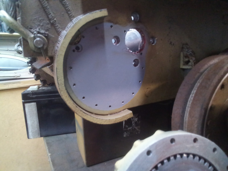

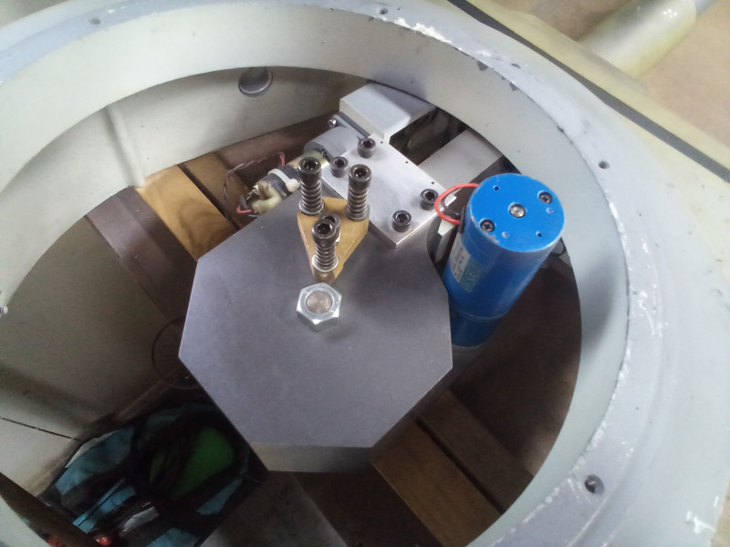

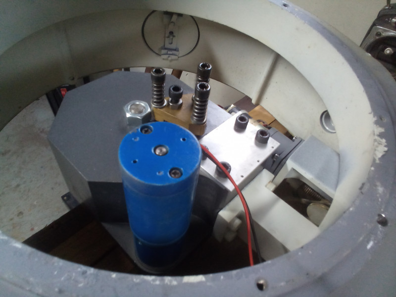

I shall be removing the blank firing device.

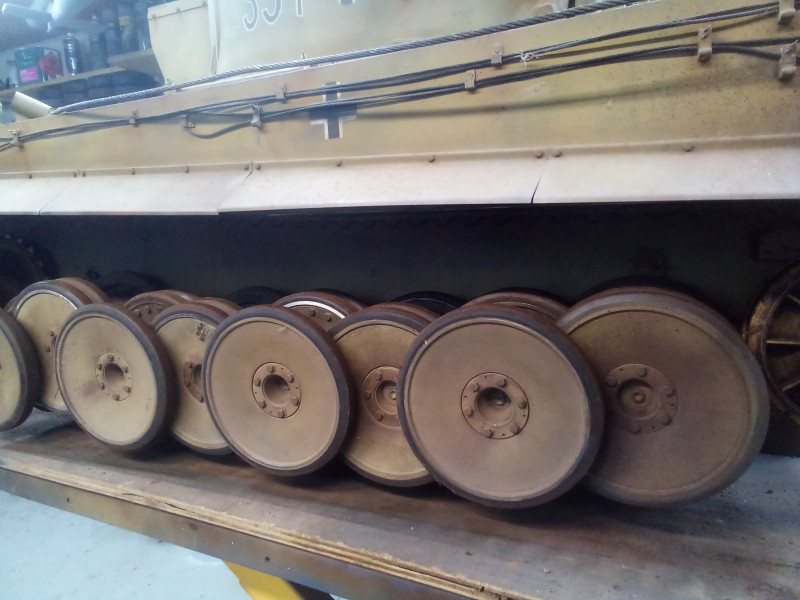

The silver rim has been turned to replicate road wheel rubbing, which happened a lot .

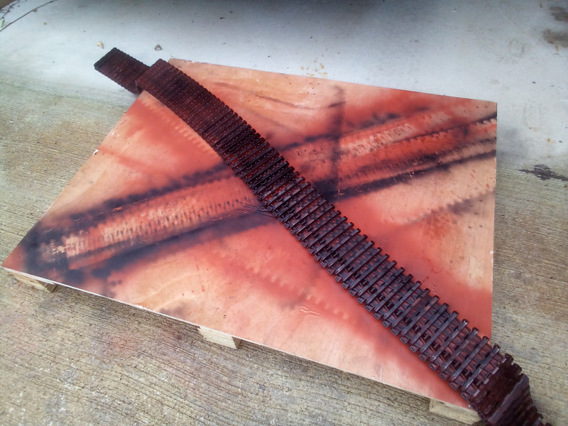

Red oxide base
Red oxide base
Matt black applied sparingly

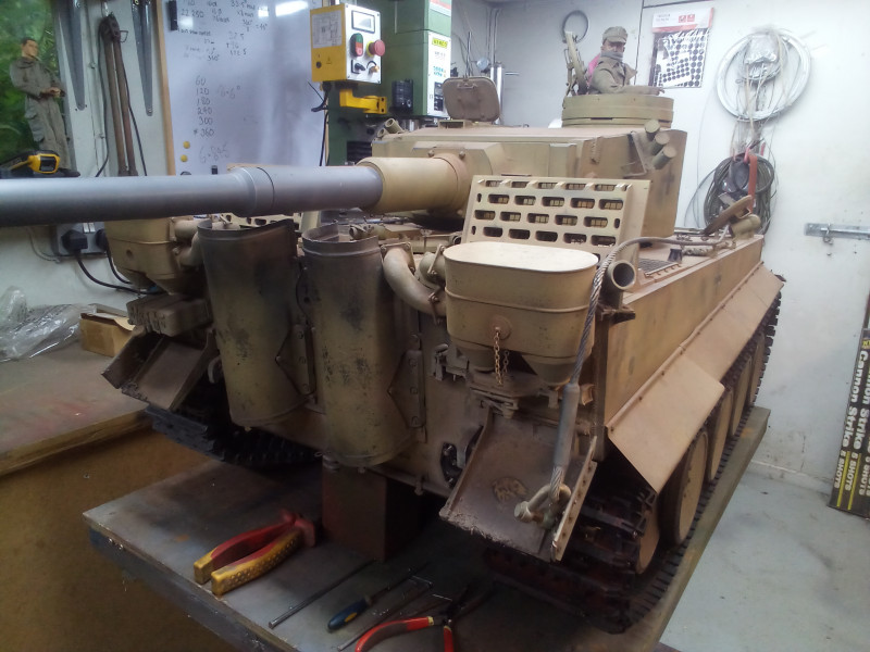

Lots of detail on this model

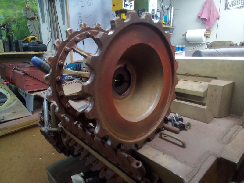

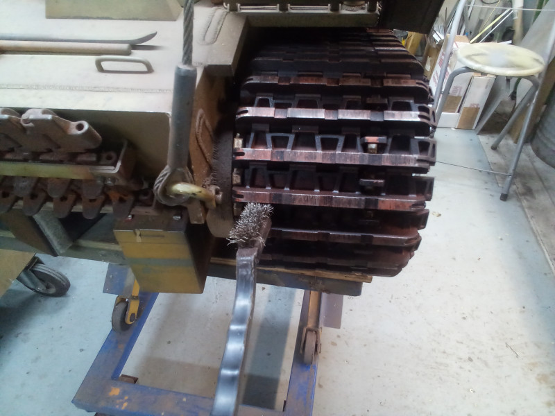

I'm using a small wire brush to remove the paint

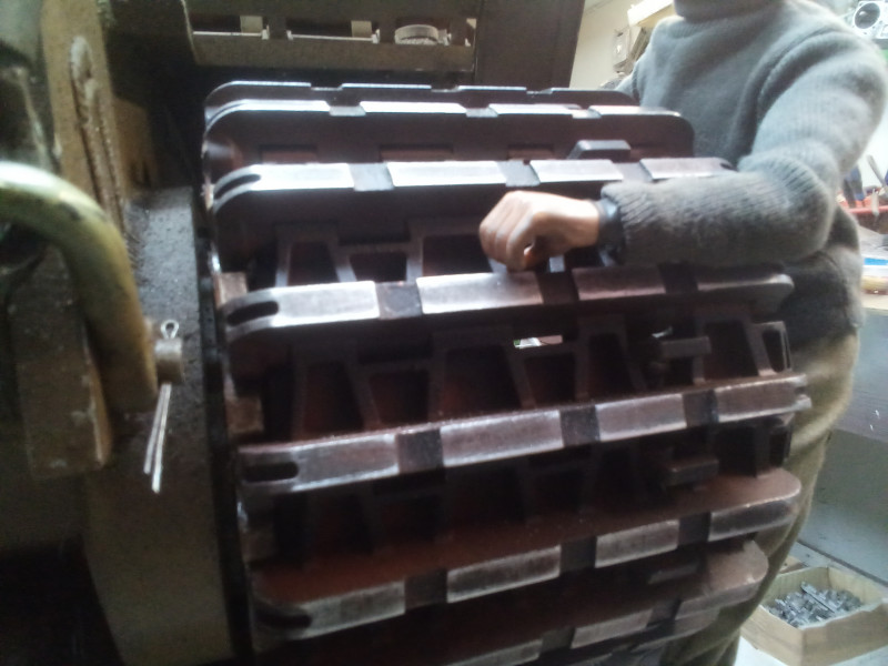

That's enough ground contact area weathering for now
With just a few minutes of run time the natural weathering begins

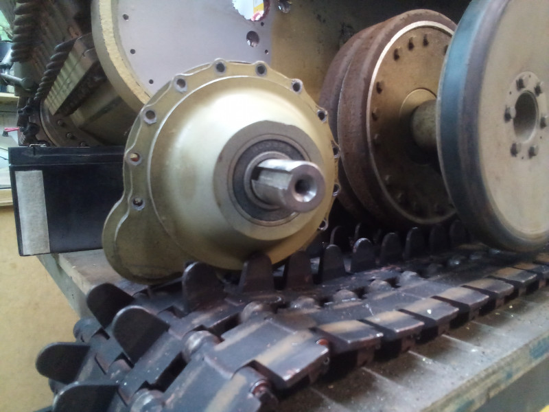

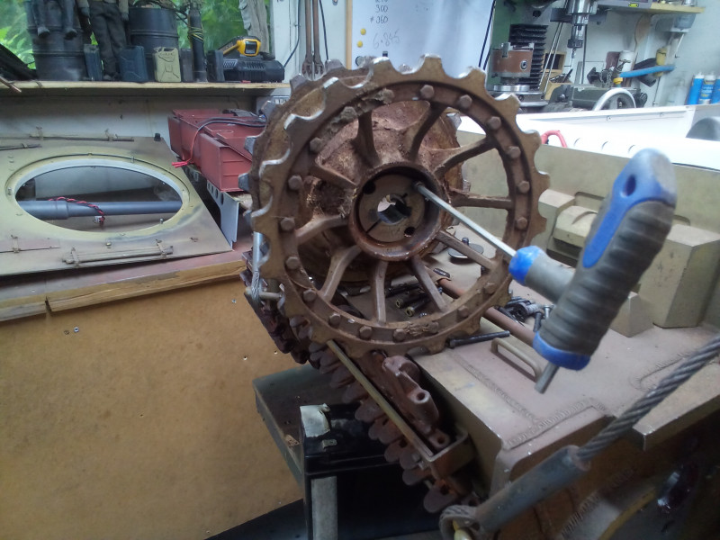

I thought I'd have a quick look at the final drive to check the "witness marks" to make sure all is well.
The sprockets are the one piece examples and pop off the without any drama ( I machined these to accept taper lock), she's had around 10 hrs run time with a nice amount of the environment build up, which I don't want to remove.
Only assembly marks on the inner sprocket cone face
No rubbing marks here.
The hull inner face that the driven gear could rub against is like new. There's no lateral wandering of the gear what so ever.
There's probably 1 mm of clearance between the faces which the grease fills nicely
Before reassembly I shall pack with fresh grease. No gasket is required, just a light smear of grease will suffice.
Re: 331 gets a makeover
The BF.

That's for the first time i see a blank fire mounted like this.
Mine are with the blanks facing the barrel.
Best regards Yves
Yes this one has more clearance below for the batteries. You also get a slightly bigger bang as the gases are more direct.
