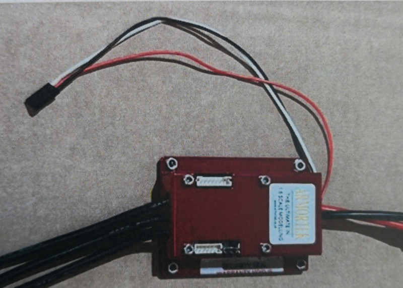

Can anybody help, where I connect these red, black and white wire?
it belongs to one of the two engines, but can't figure out where yo connect them.?

Probably to one of the channels on the R/C receiver.

if you really don't know where to connect these cables i suggest you to not do that, you will get very inguried. instead.if connected incorrectly, it can cause the engine to start immediately

Don't these things come with instructions?? Without going too far out on the limb I'd say that sort of connector (- + S) 'traditionally' has something to do with an interface to the RC system. These are seldom used for other purposes in RC models...
The unit looks suspiciously like a brushless motor speed control.
Get a copy of the instructions or message Armortek.
Has liked: 1492 times
Been liked: 1699 times
Re: Power engine wire help
On the Panther brushless motion pack "Wiring Schematics" page, those leads are marked as "RC IN" on the XMP101A and XMP101B main motor controllers and are shown going to Channel 2 and Channel 3 on the receiver, using "Y" splitter leads.

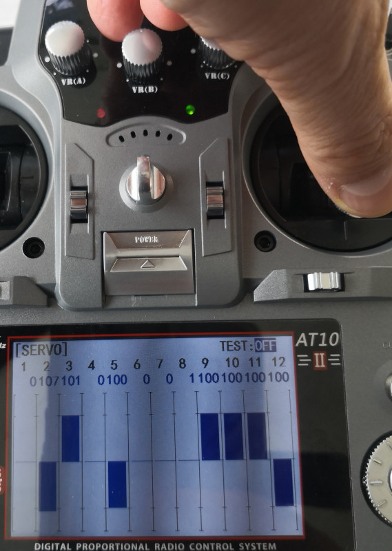

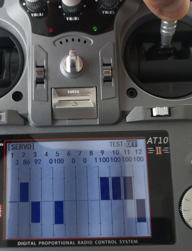

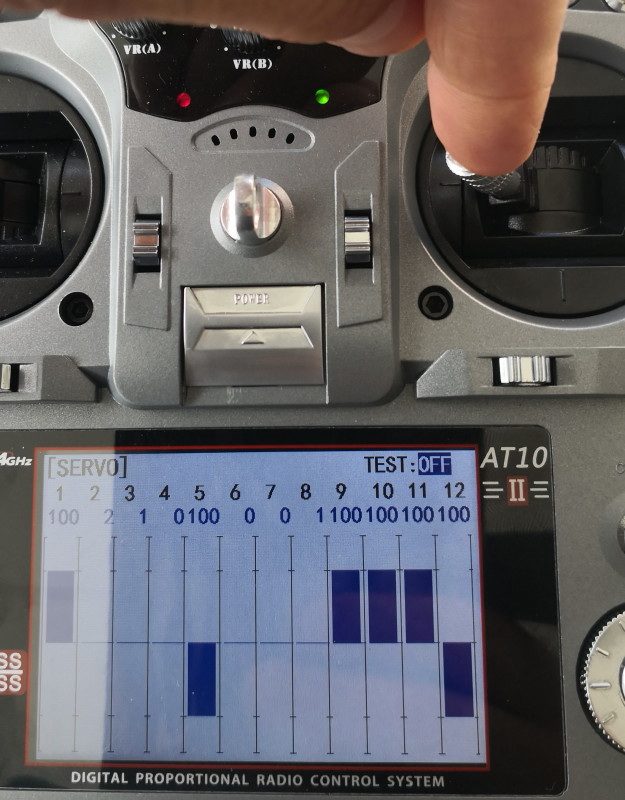

Post by KimLarsen »
Here are some pictures

Hi Kim
Is it driving forwards and backwards on the same stick but you have no turn ?
Left stick or right stick ?

Post by KimLarsen »
It runs forwards and backwards on the same pin I Højer pin.
But I would also like it to turn on the Højer stick.
