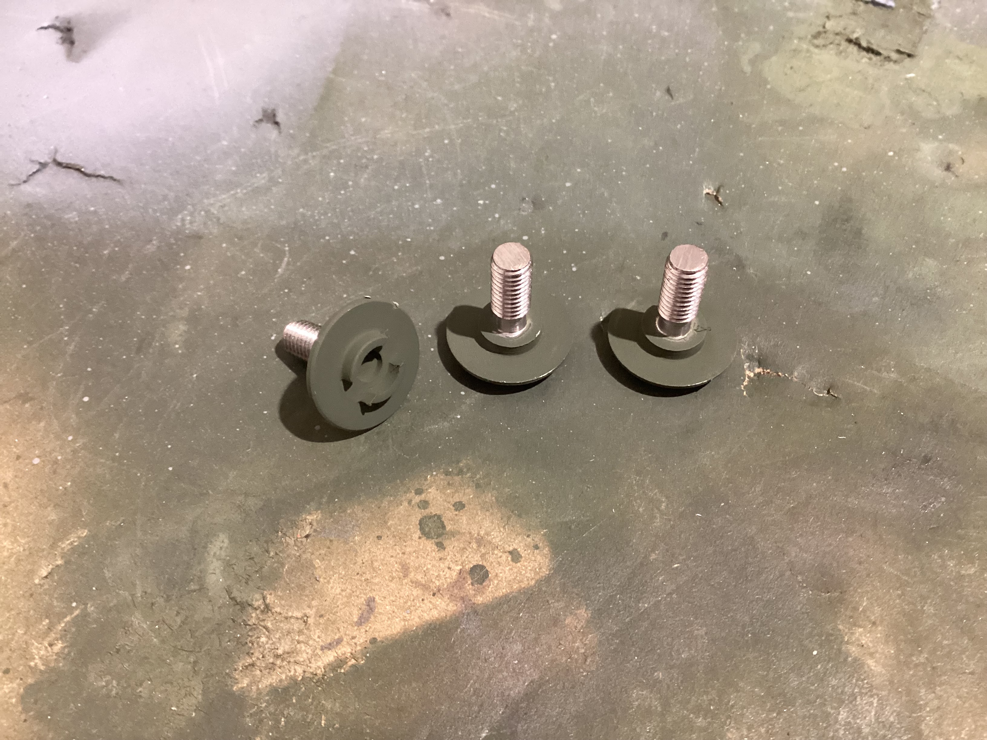

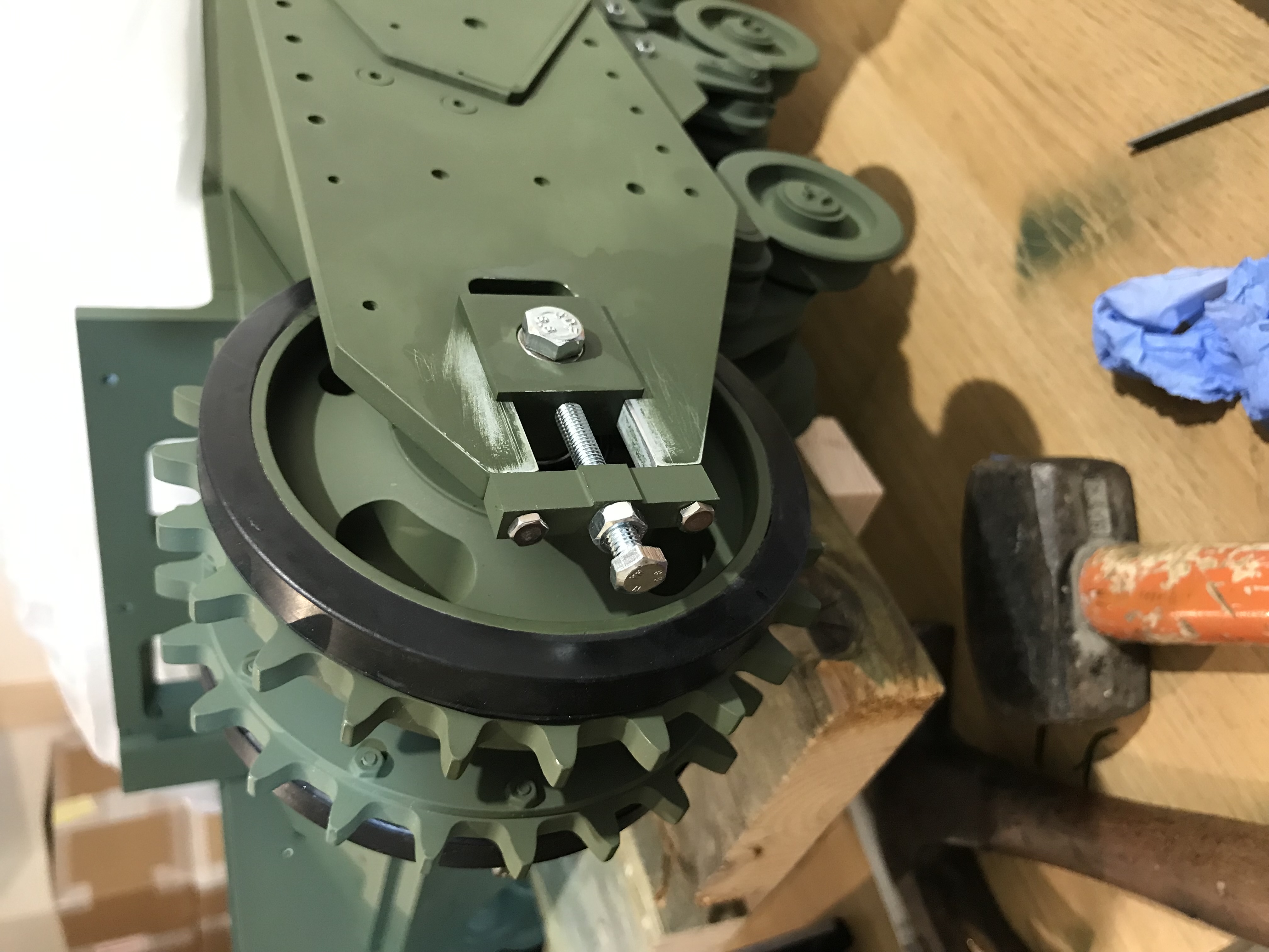

Thanks Gary….agree the hammer was a panic measure as the thought of trying get them out was weighing heavy. Yes one bush head did slightly deform on one side, but as it was on the pivot shaft that moves between the carrier frame a clean up with a file removing only a small amount made it fit nicely in the frame. Must buy a bigger vice.

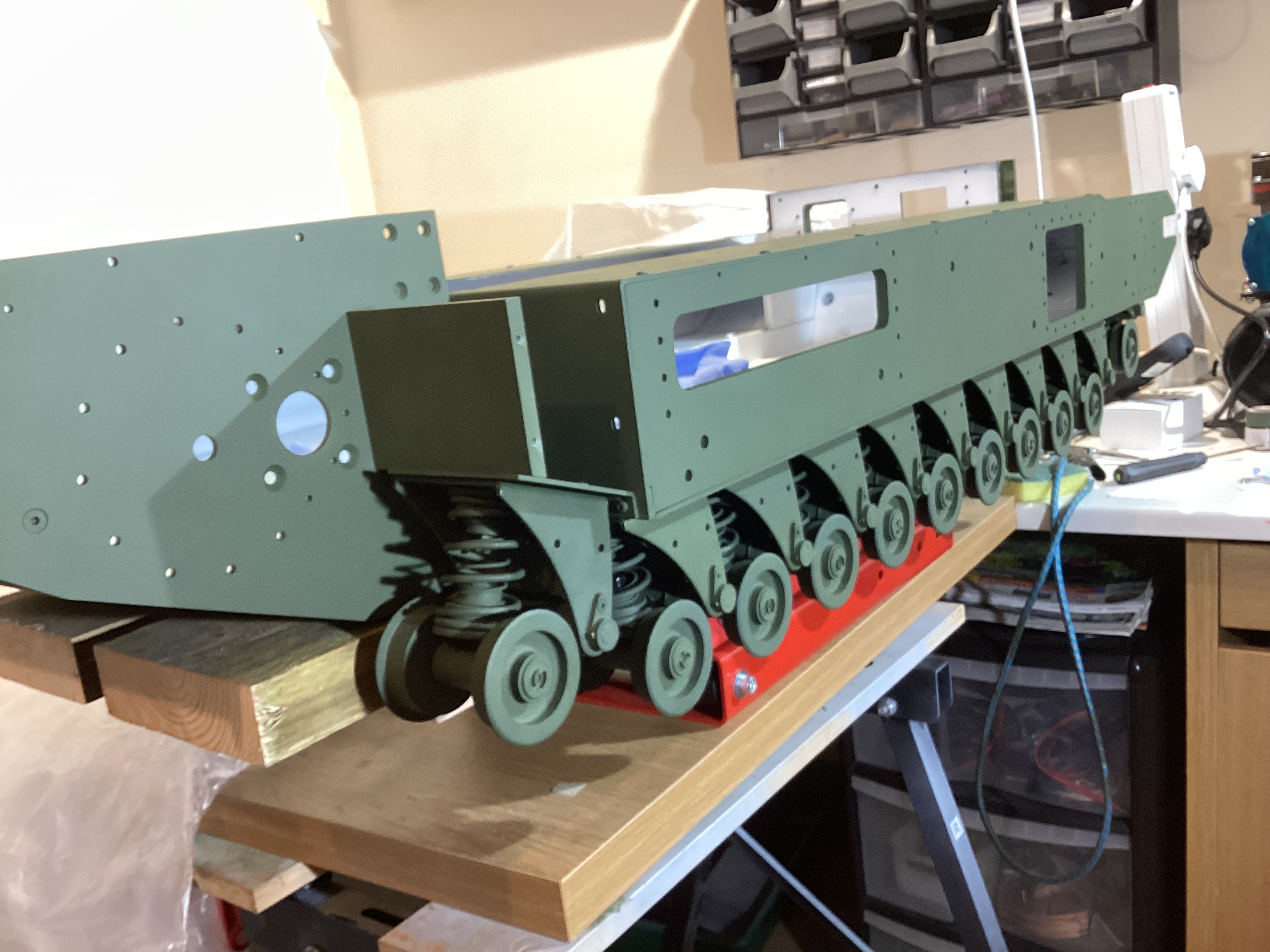

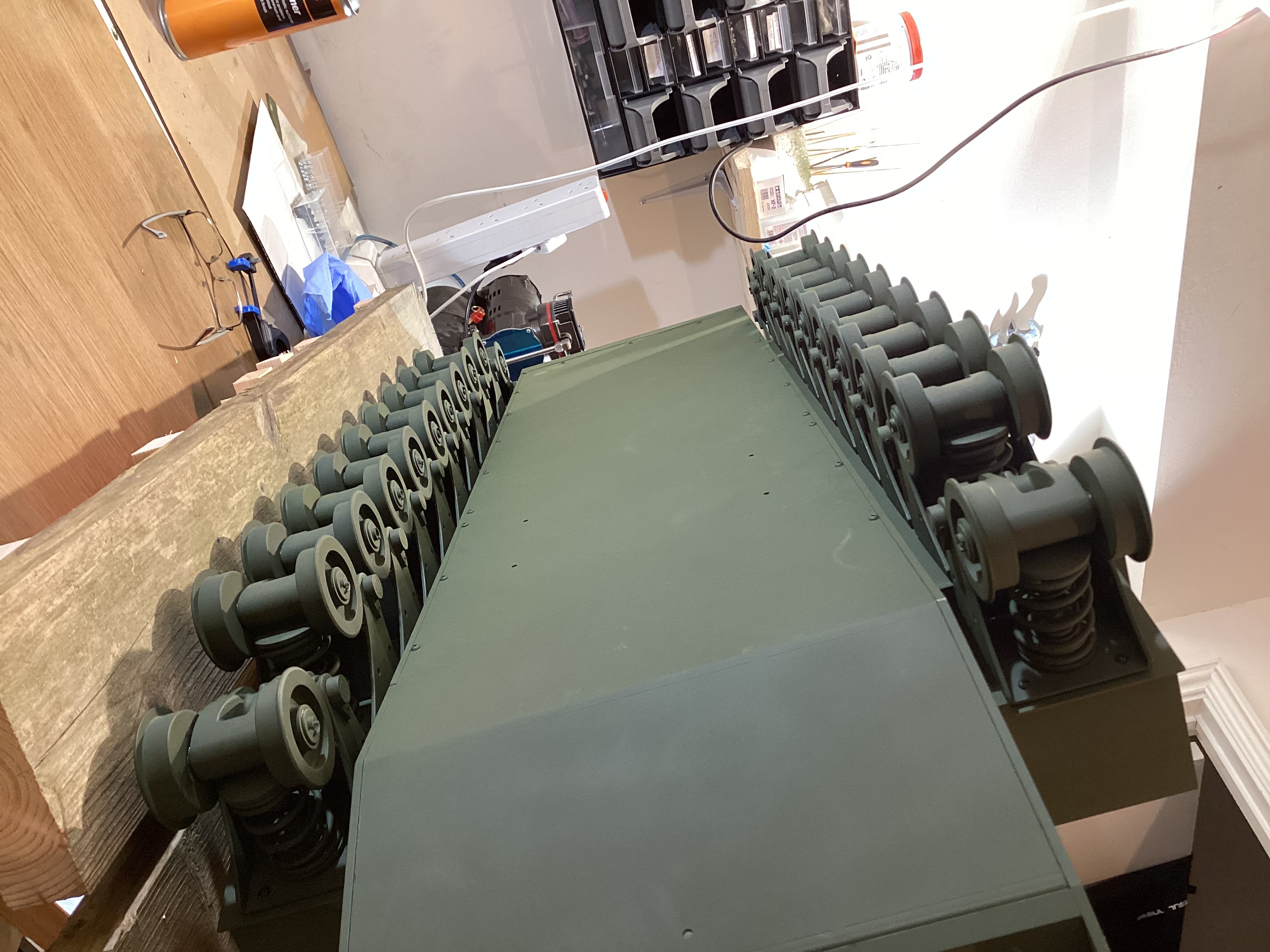

Very pleasing to finish a build sequence, if somewhat slowly.
Glad the above is now behind me

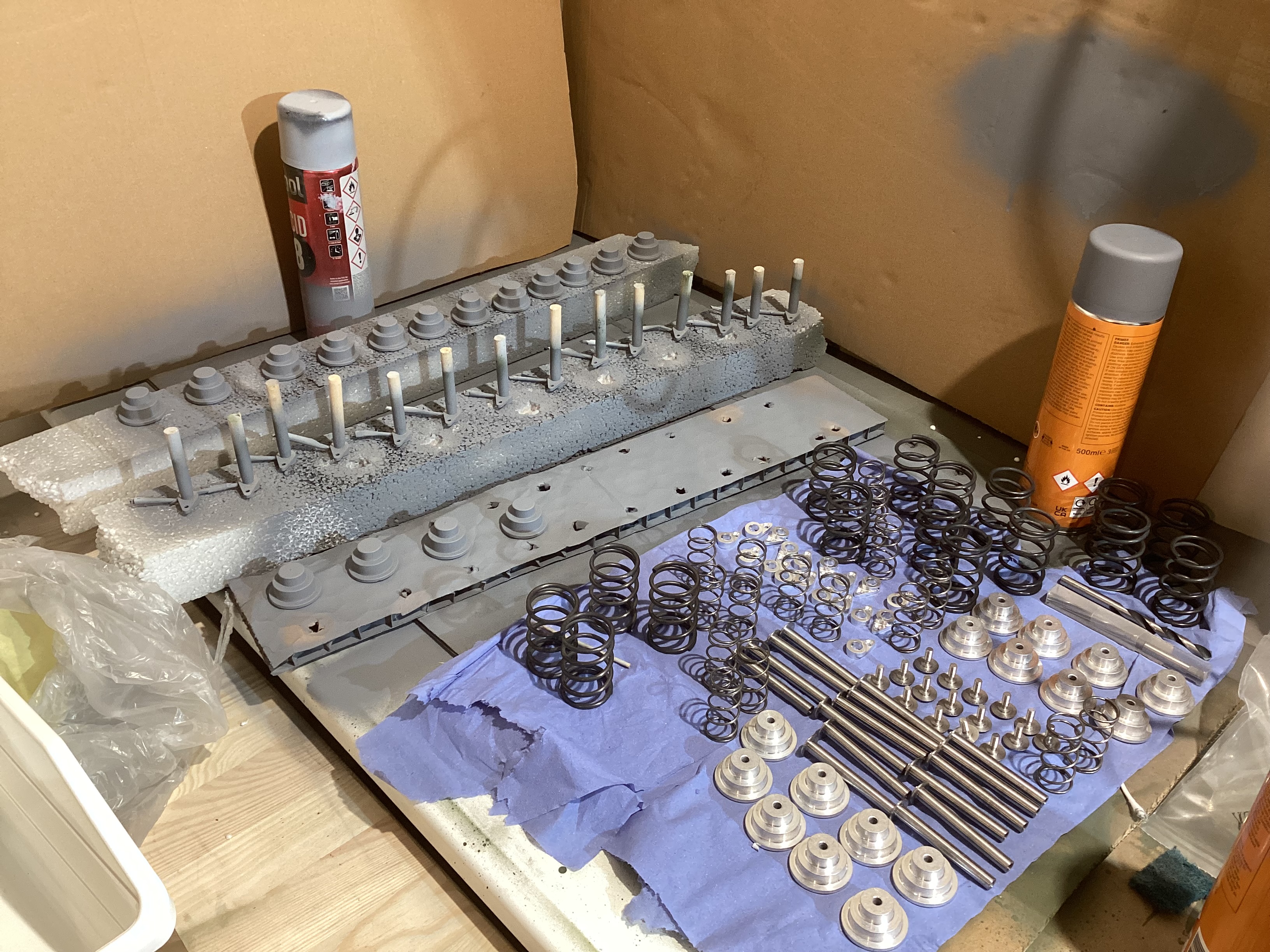

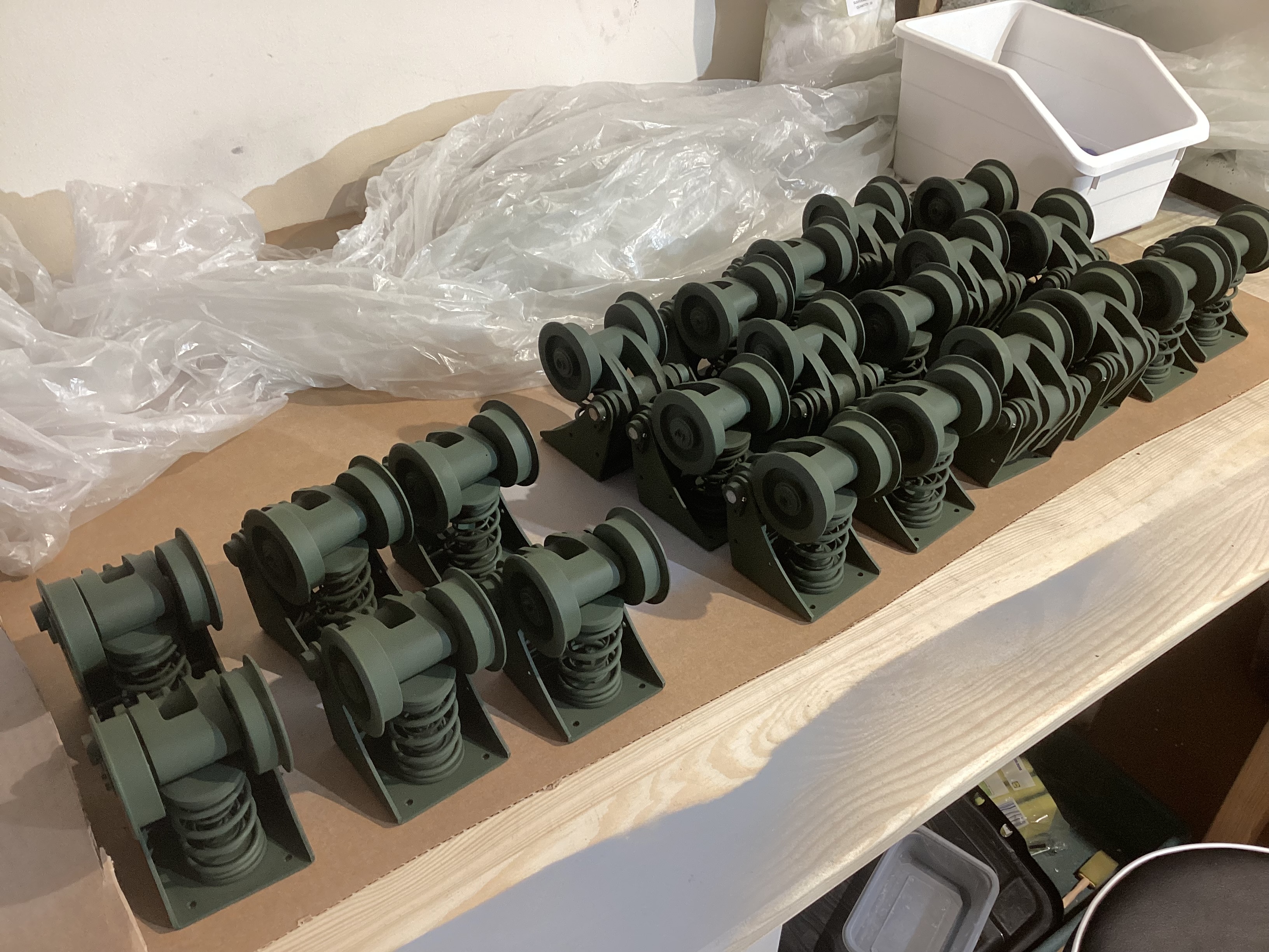

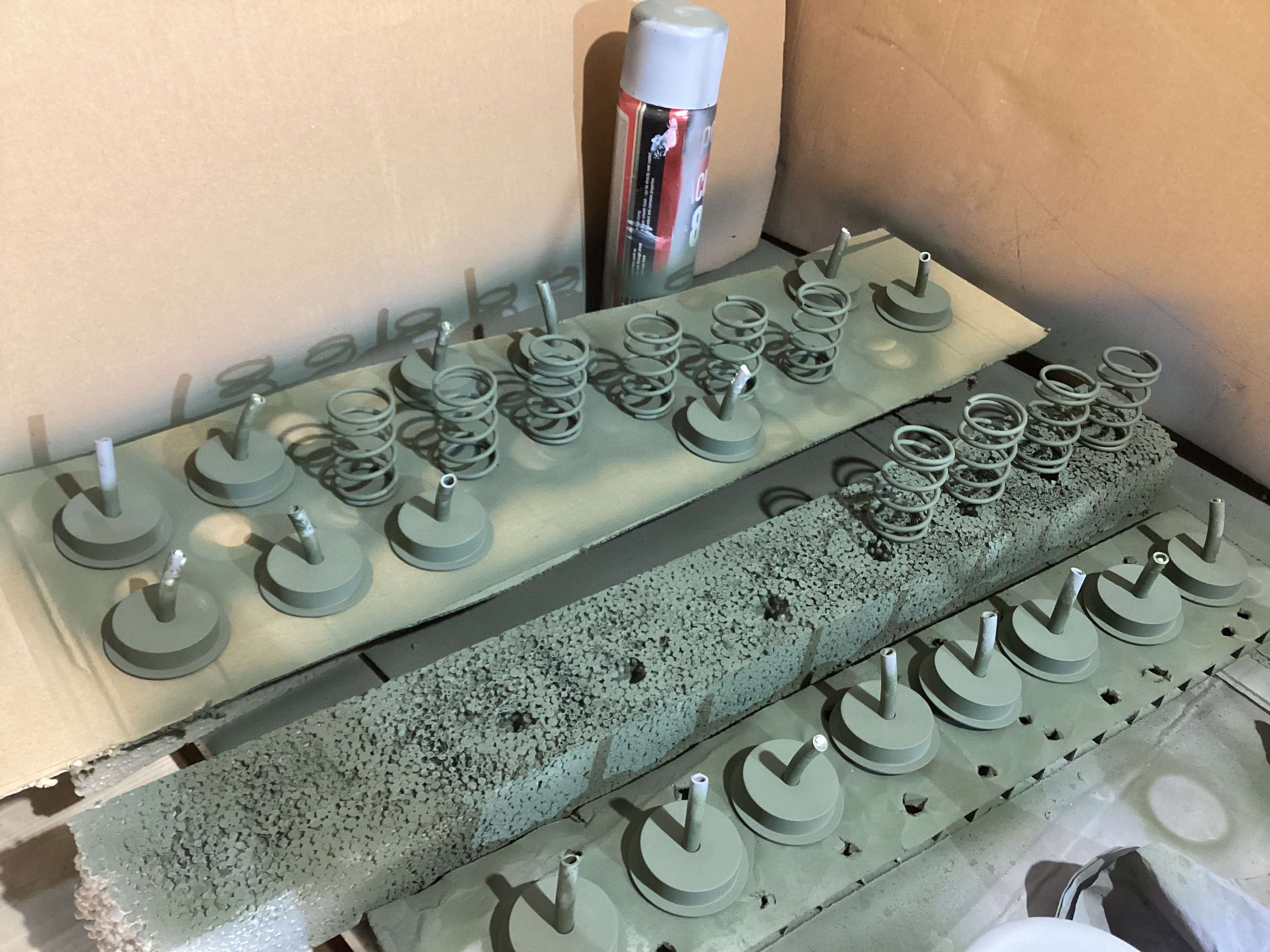

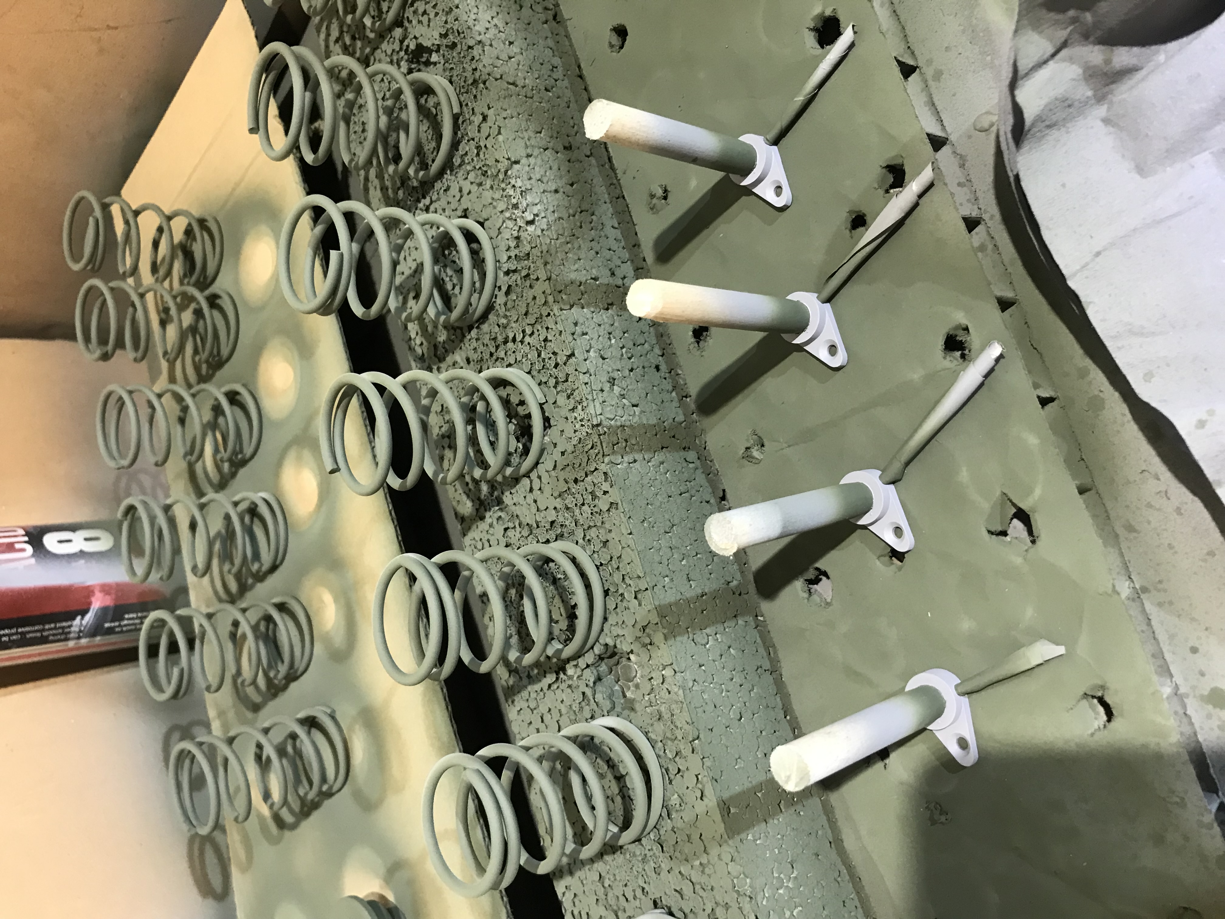

Hi all
A couple of newbie build questions, up until now I have primed and top coated all parts individually and thereafter assembled sub assemblies. As I move onto sub assemblies like the idlers I was thinking of building the assembly and then priming/top coat after assembly to allow easier fitment etc obviously taping up axle etc with the tyres fitted last. from what I have experienced so far paint build up at parts seems minimal so just wondering what others have done with such sub assemblies.
michael hilton
Posts: 1198
Has liked: 1566 times
Been liked: 836 times
Re: Churchill 58
Post by michael hilton »
Good evening Andy, over the years I have purchased a number of various sized sticky backed labels, square, round etc,. I use these to blank off the bearings, then masking tape wrapped around the idlers to protect the surface where the tyre is fitted. Prime, undercoat, topcoat. Most, if not all my painting is managed using this method....just my choice. Hope this helps...Mick
Andy Cameron
Posts: 53
Joined: Thu Feb 16, 2023 9:41 am
Been liked: 58 times
Re: Churchill 58
Post by Andy Cameron »
Thanks Michael I will forge ahead….we’ll crawl ahead (need to stop coming out the garage) using this approach on such assemblies.

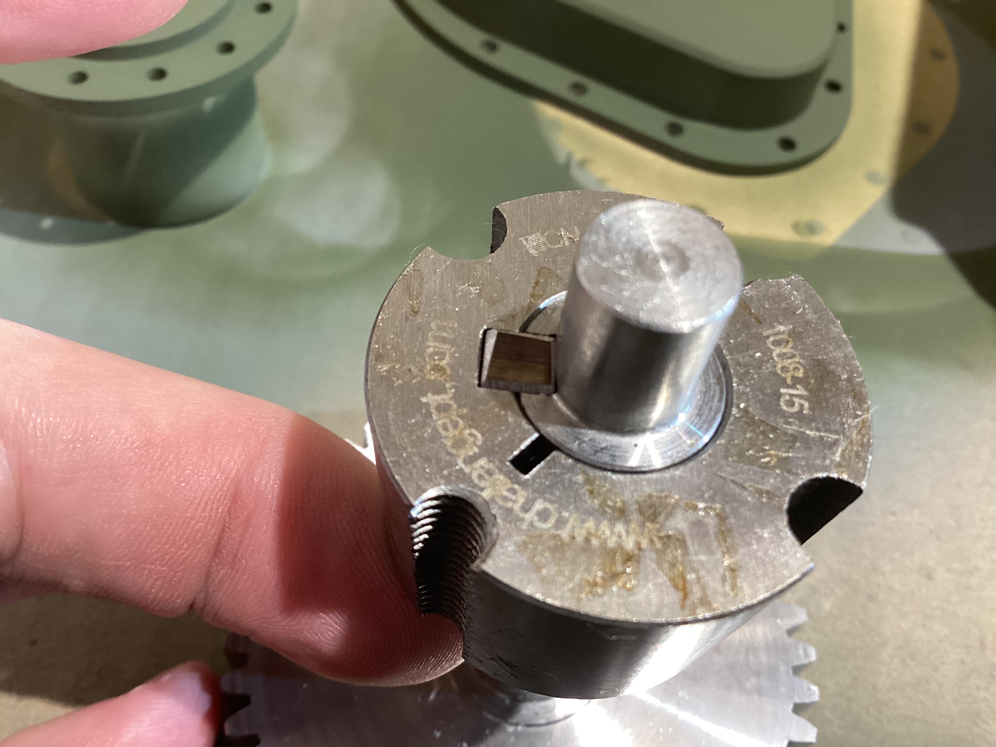

Hi all, can I ask for some advice on the drive sprocket assembly on section 11. I am probably reading too much into this but the sectional view shows the taper lock bush being slightly proud of the hub face at the widest taper end. As the instructions on the following page say to “gently to square it up” tap the bush after seating it with grub screws then tighten finally once more I want to confirm if the bush does sit slightly proud I.e. don’t over do the final seating stage trying to get it flush. Prior to this stage the instruction say to locate the bush in the hub and “shaft” at this stage the final drive shaft is not installed so if I fit the taper bush into the hub without the drive shaft present am I inviting fitting issues of the drive assembly later down the road at section 14.
Andy Cameron
Posts: 53
Re: Churchill 58

Hi all
My build is still plodding along front idlers in (with re-painting needed but they spin nicely)
So now to the rear drive sprockets where I could do with some confirmation, it all looks quite logical and I believe that so long as the main drive gear EX0220 is butted up against the 6002 bearing face once everything is tightened then good to go. On mocking up there is adjustment possible of the taper bush either with its face flush to sprocket housing or slightly below as per the
Is this irrelevant so long as the main gear drive has no lateral movement and the taper bush face is at least flush to the sprocket housing or just recessed below.

Having had another good look at this my way forward will be:-
Bearings set as required and I will use green wicking Loctite on the bearing outer race just to hold them even though the larger bearing is a slight interference fit and I inserted after freezing the bearings and then heating the enclosure. I am not using bearing lock on these ones.
The main gear shaft I will Loctite to the inner race of the larger bearing probably using bearing compound ensuring it is butted up against the bearing face to ensure a slight gap between the main gear and the hull side. This now gives me a solid point where the shaft cannot move laterally. Now I can use the taper bearing to fit the drive sprocket to the shaft with some lateral movement of the sprocket on the shaft possible for track alignment courtesy of taper bush have some movement possible laterally on the shaft .
The smaller bearings in the hub are a looser fit so I will use green wicking locktite again to secure the outer race grabs in the hub and then once all assembled I might use a small amount of blue Loctite on the inner race to shaft just as a grab so that if the tracks need adjustment in the future the side plate can be easily removed to allow taper bush adjustment.
