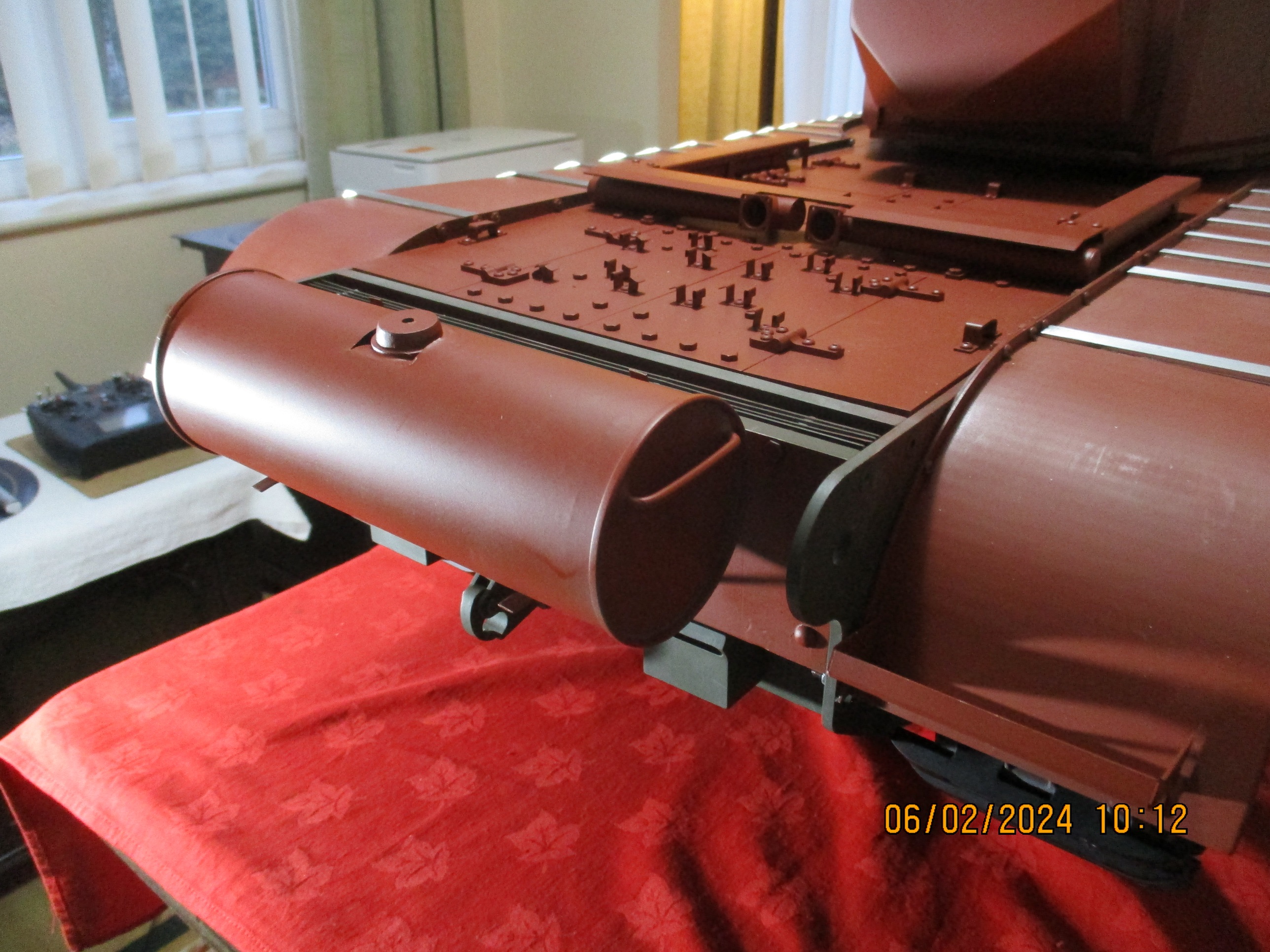

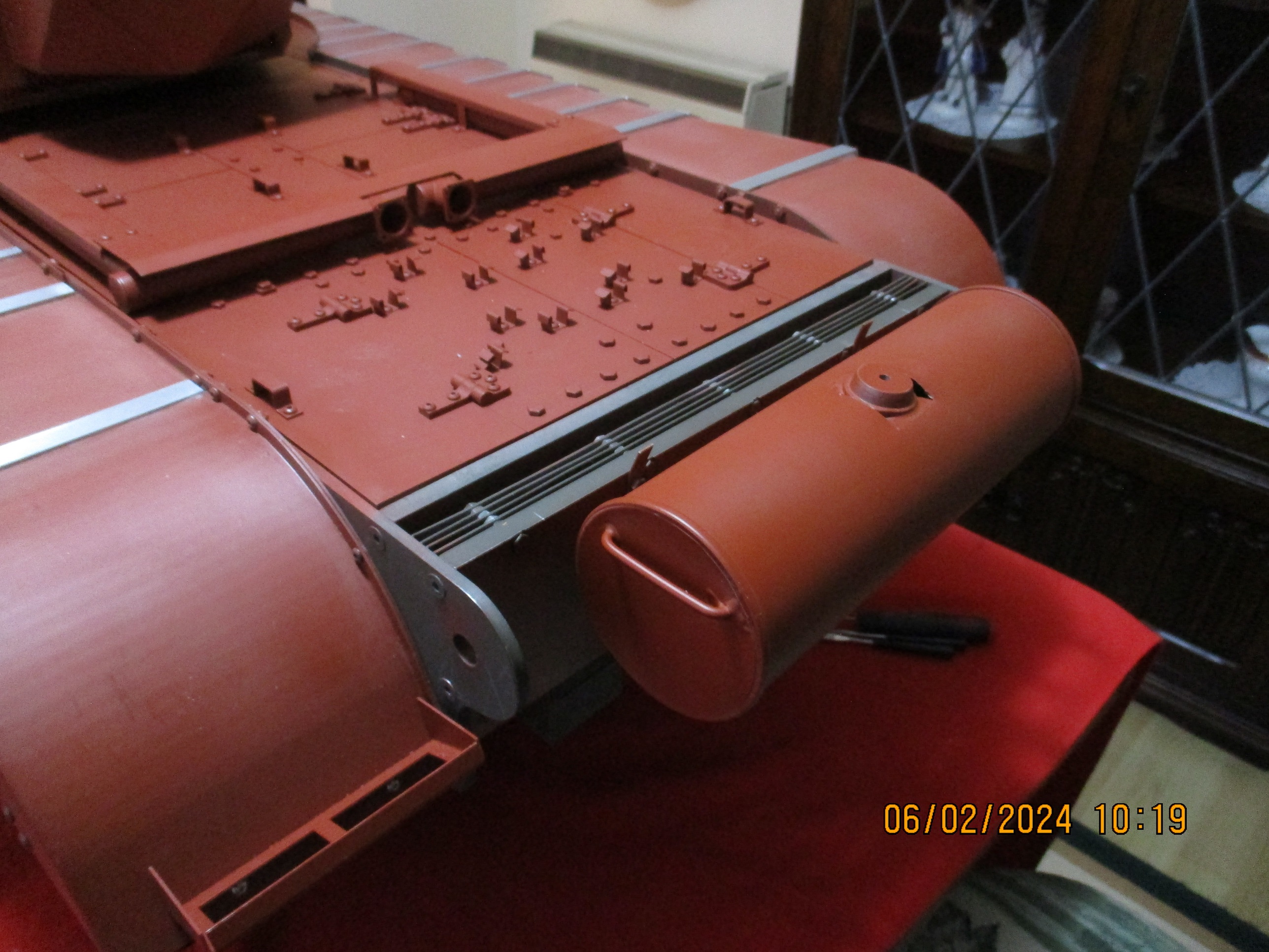

Good morning everyone, I do my bit Adrian....the fuel tank is a little ''stand off '' job that does not test the brain box.....adding the brackets next. The jack boxes will be tweaked, I like to keep it simple.....just trying to put my own stamp on the old girl....Mick

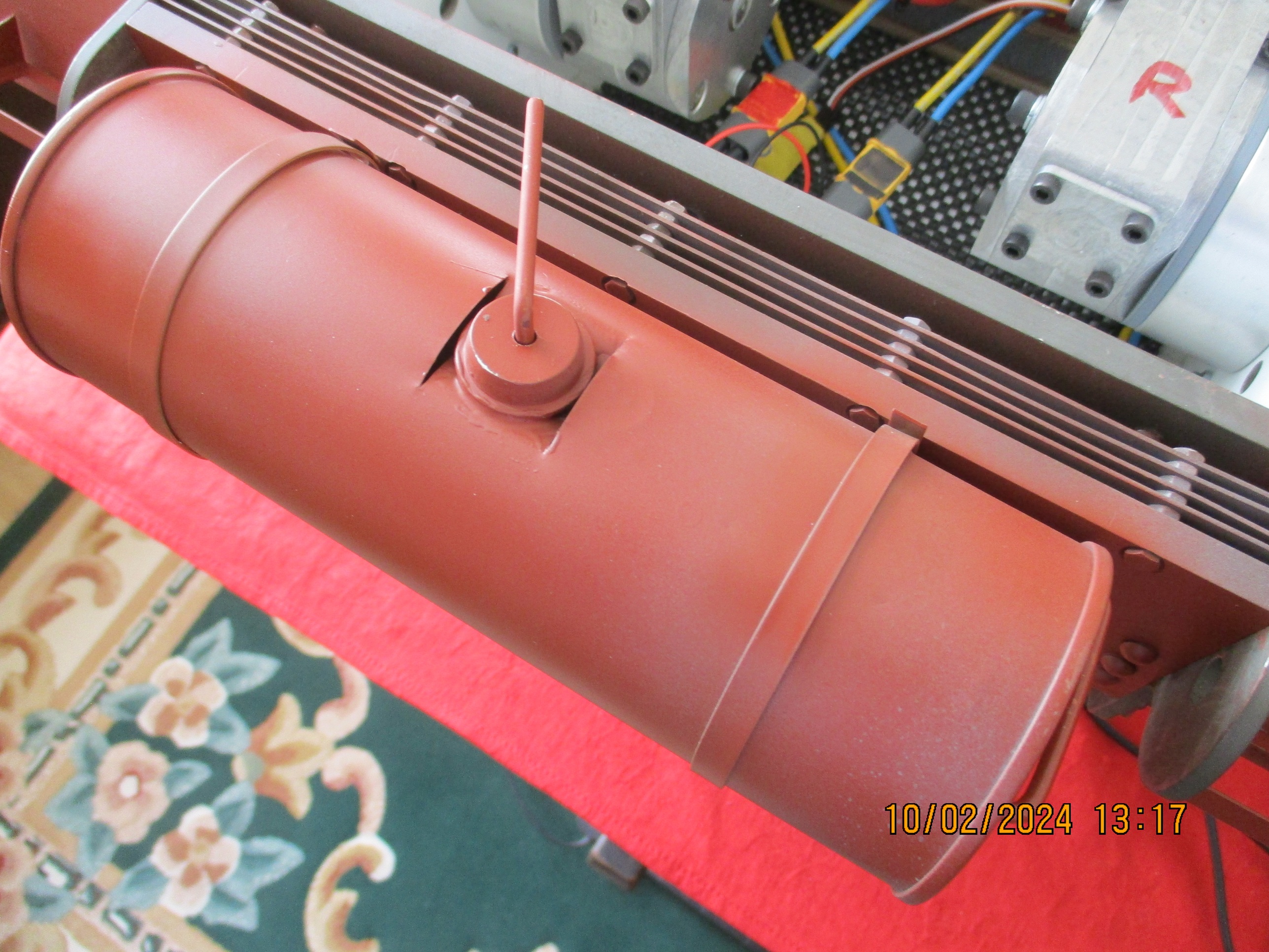

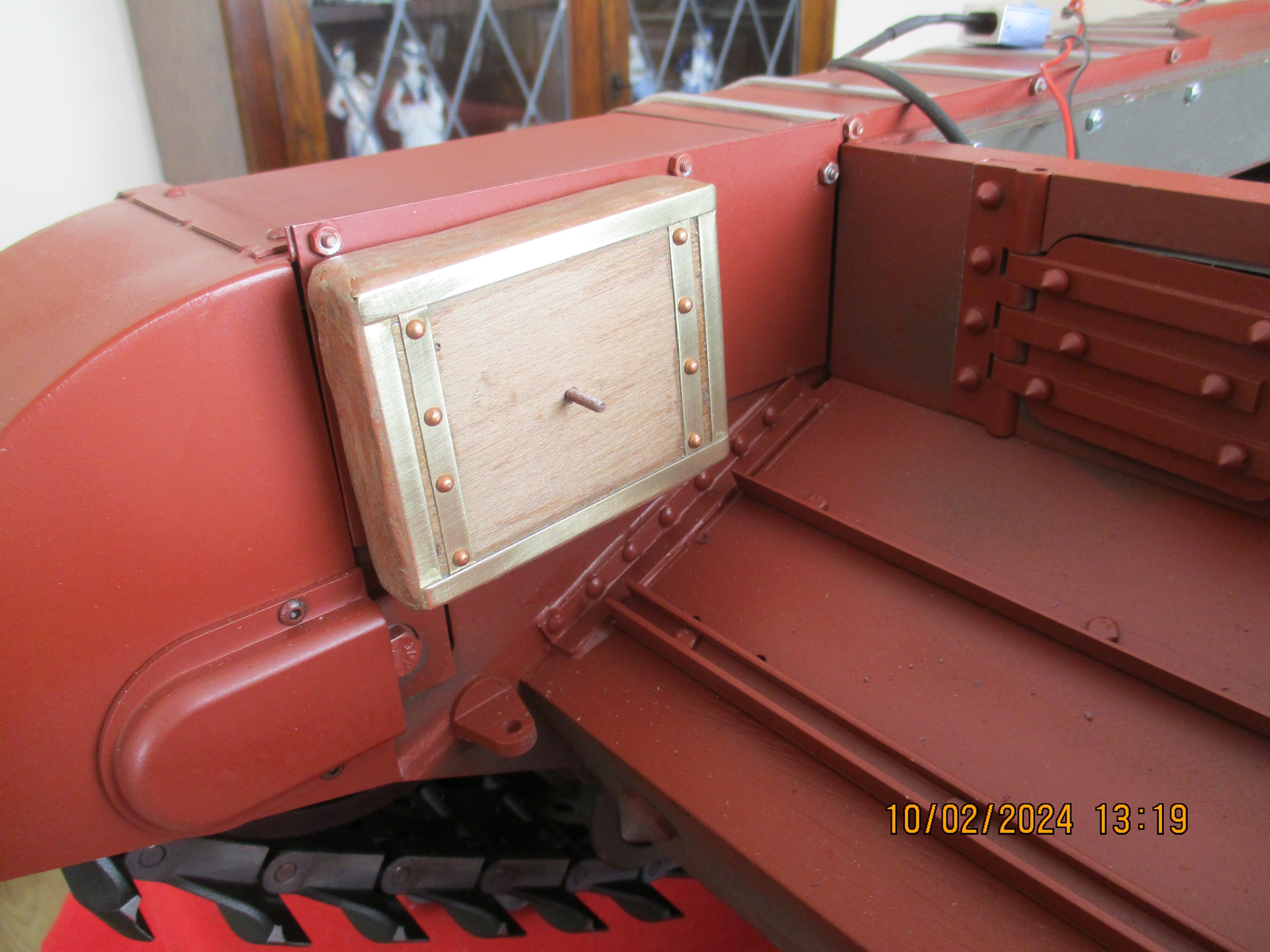

Good morning, what a lovely day to be saying ''what a lovely day'' will remind myself to switch off the heating, I'm not made of money :) The fuel tank is more or less completed and I have reworked the Jack Blocks. That's all for today, have a nice one lads....and the girls....Mick

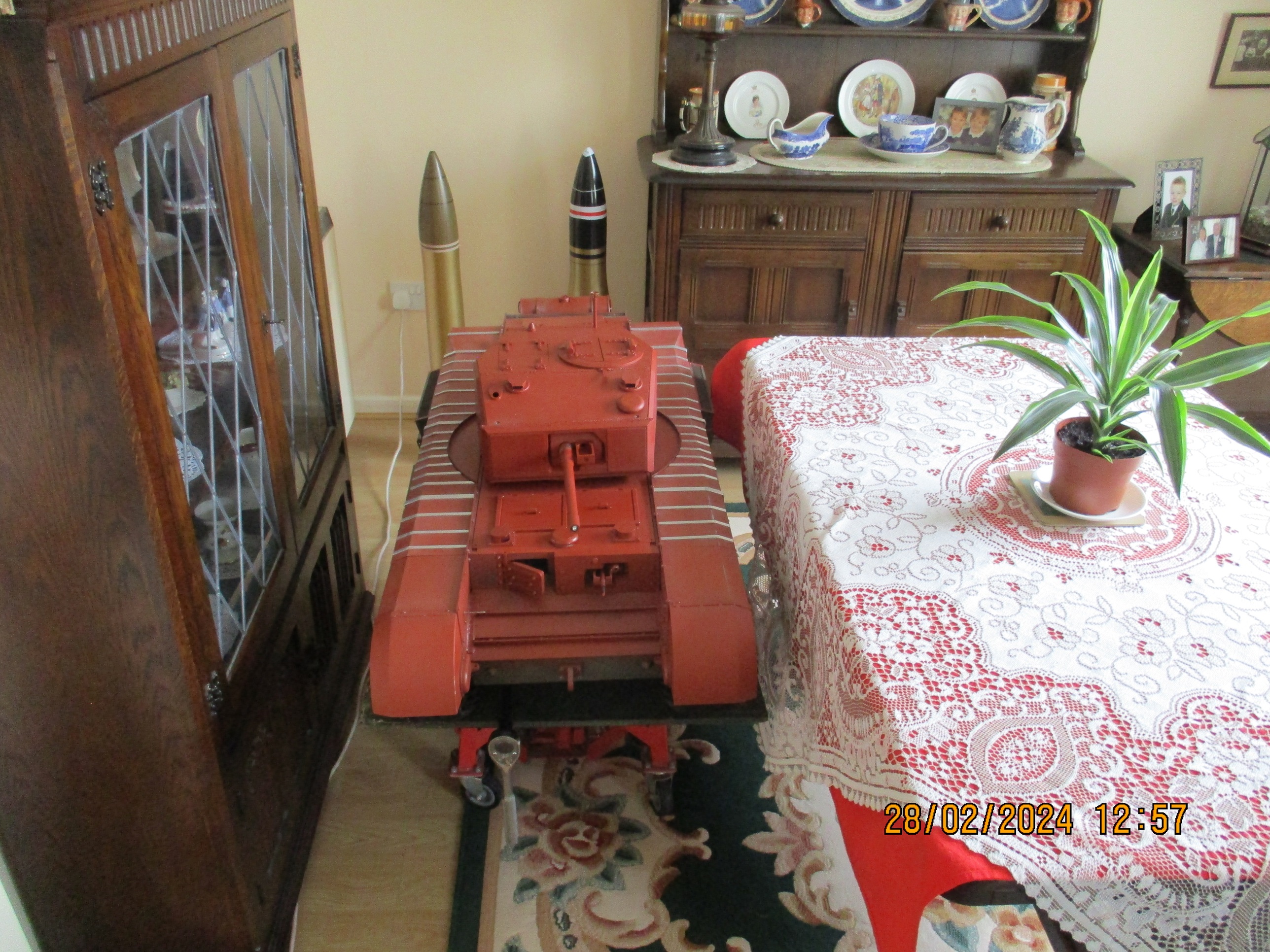

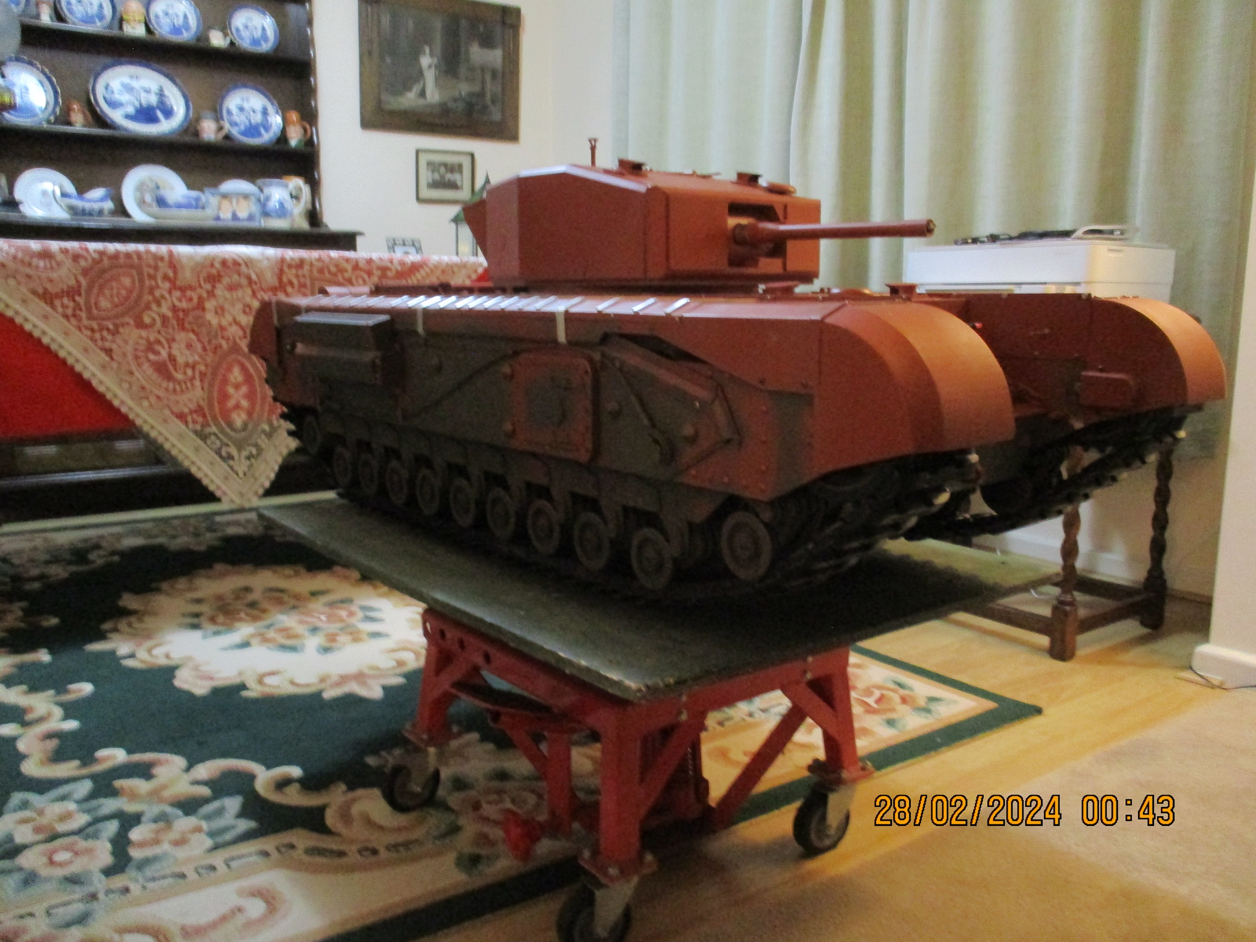

Good morning lads, moved the old girl off the dining room table into safe mode....I am a combination of old and new....oh and the weather is awful, roll on Spring...Mick
