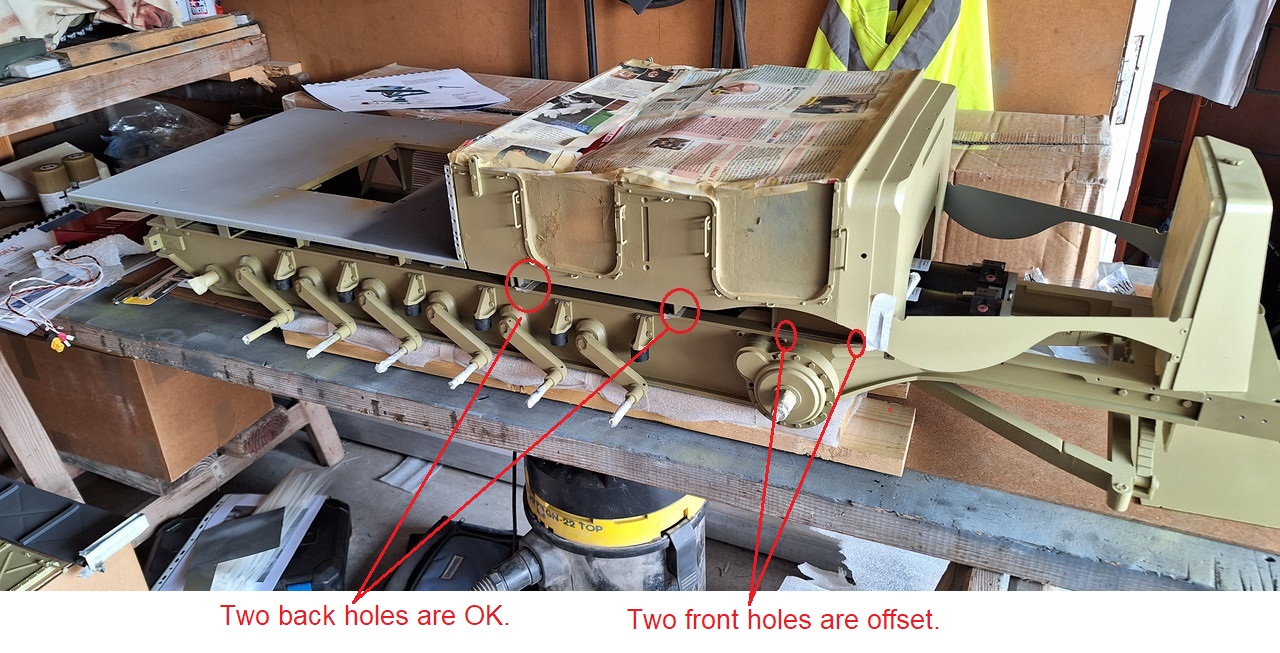

Hi Yves,
Like your FAMO building progress.
Found your FAMO front compartment had been on and off the chassis more than once. Have you met any difficulty of screwing-on the eight positions ( four on each side. See red circles on your photo.)?
I have tried doing so , yet could only screwed on two back holes. The from two holes were in a few mm offset.
Is there any procedure I have done incorrectly , or any trick I have missed ?
Regards,
Lerh Chang
Updated : Now I have sorted out the "a few mm offset" issue. But still a lot of other issues to go ...

Hi Chang,
I Did take off the front more than one time that's because i wanne fix the nose front of the famo first.
The loading area is al ready fixt. To screw in all the bolts it's a bit of hell. The holes line up correctly but no easy acces.
I use on the outside the M3 hex bolts and on the inside i use M3 button heads ( more easy to screw them in) and these ones you donth
see from the outside.
Now i'am working on the dashboard ( with lights ) and the front window ( can open and close ) that's also a lot of work.
If that is fixt i put the front of the famo back on.
Best regards Yves
