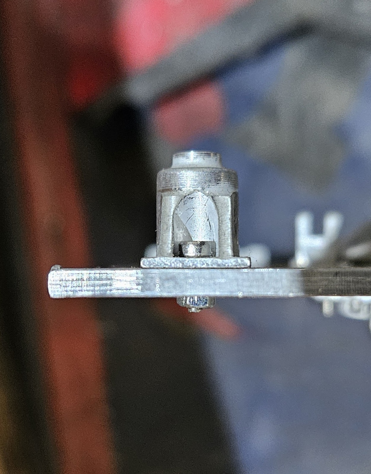

Looks like there might be a misprint in the build guide on Step 27. Assembling the turret deck rope clamps, the guide calls for an M2.5x12 CSK for the threaded post and an M2.5x16 CSK for the attachment to the deck. That appears backward to me. With the folding top of the clamp at 90 degrees to the body, that M2.5x12 does not stick through the top plate far enough to put a nut on it. The M2.5x16 also seems way too long for the mounting screw. Even the M2.5x12 hangs down below the deck plate quite a distance. I think I am going to build these clamps with those screws swapped.

It's tricky comparing manuals from different production runs but the Tiger 131 kit used M2.5x12 for the threaded post on both the large and small clamps. The large rope clamp used M2.5x10 CSK bolts to hold them to the front deck and the small rope clamp used M2.5x20 CSK bolts to hold them to the engine deck covers.

Thanks Adrian. I haven't Loctited these in as yet so I can always switch it back, but that M2.5x12 just seems way too short at first glance, and the x16 really hangs down below the turret deck. I'm going to leave them as I have switched them for now and I will dig out the rope and see how it fits in the clamp. Perhaps the clamp needs to close down past 90 degrees, in which case the x12 might be OK.
I have to admit, I don't understand what they are doing on this turret deck plate. These rope clamps all call for M2.5 screws, yet the holes in the plate are at least M3 in diameter. The screw fit is extremely sloppy and the little M2.5 nuts want to tip into the hole unless you get them precisely centered. I may end up putting a washer on them since the screws are long anyway. The M2 screw and nut for the headlamp bases is an even worse fit in the M3 holes there. The only thing I can think of is it may be faster and easier in production to drill one size hole, but meh...

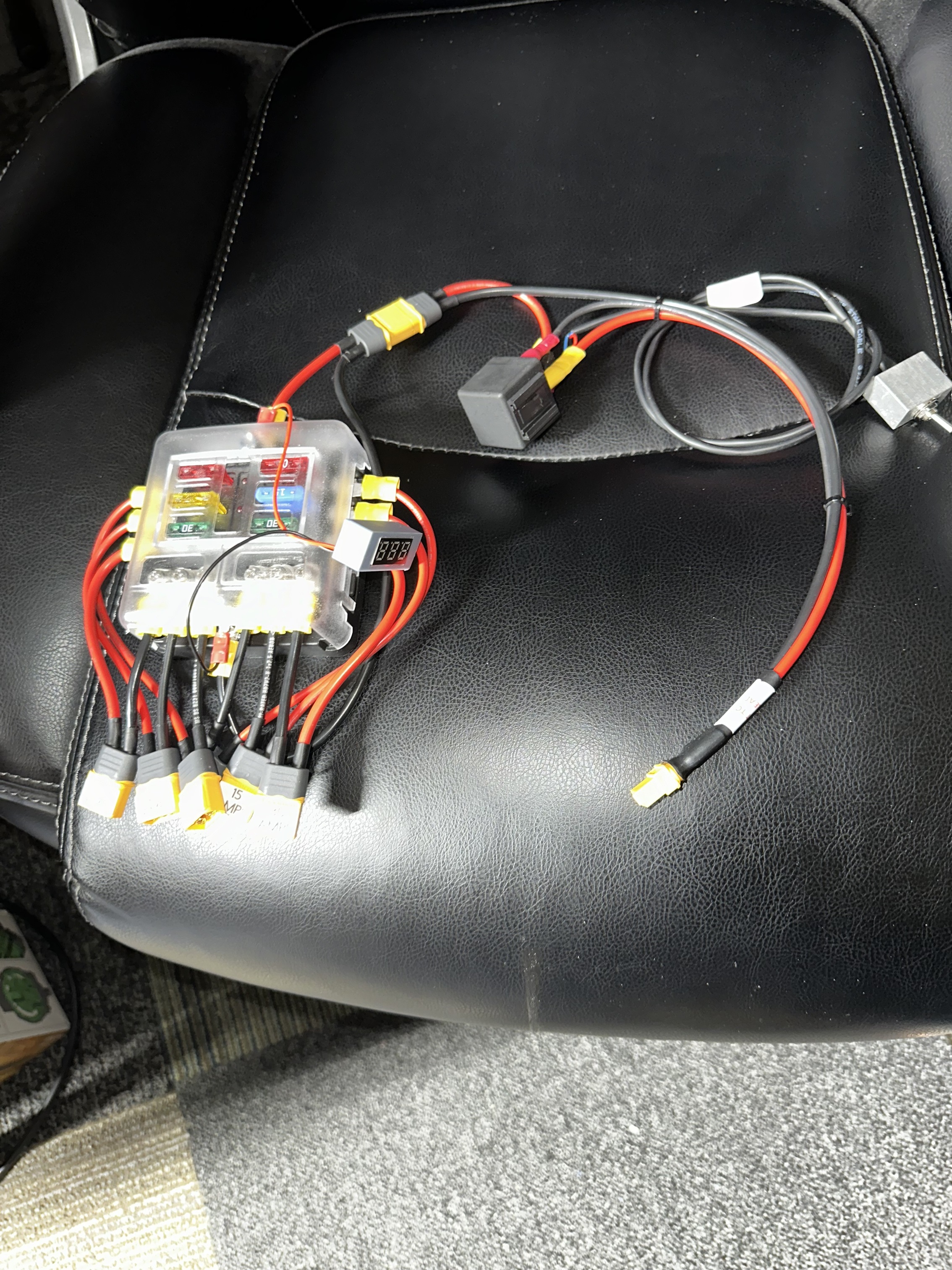

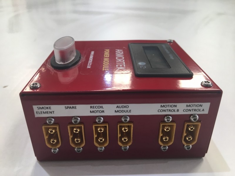

Got to opening and examining the Option Pack shipment and, I have to admit, I am a bit underwhelmed.
The new Power Module looks decidedly amateurish compared to the older one. I guess the newer one has some design improvements, like separately fused outputs, but is this seriously the best they could do for packaging? Truly ugly, with a bunch of stuff sticking out all over the place, the battery indicator just floating loose on two wires. It seems like it's going to make for one messy-looking installation... On the drive front, there's now a second pair of taper lock bushings to contend with on the belt pulleys, with the accompanying alignment requirements and concerns. I'm not sure why the drive system couldn't have been engineered with sufficient precision to use a fixed-geometry design.
Well, guess I'll install it all and see what happens. I can always look to find an older system and swap it out if desirable.

Re: Dave's Tiger I (Early) Kit Build Thread
Hello Dave,
The reason for changing from the red box power modules to the latest release was time frame, The red boxes were a very time consuming item to make and put together, The latest power module are more off the shelf item, Still have to make all the wiring and assembly them but a much quicker item to release, The idea of the loose battery voltage indicator was that you can place the display were you want so it can be seen, Making any wiring look neat and tidy is difficult but can be done by using cable tyraps, tyrap blocks and spiral band etc.
The option packs are a very time/labour consuming part of the kits to put together, So anything we can do to speed production up is to aid the time period the customer has to wait, We are trying (not enough hours in the day), And by all means feel free to come in and give me a hand,
Kind regards, Chris.
