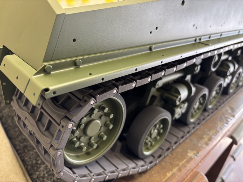

Drive sprockets fitted.
Tracks fitted.
Tracks fitted.
A couple of pics.
A couple of pics.
That is the running gear completed.

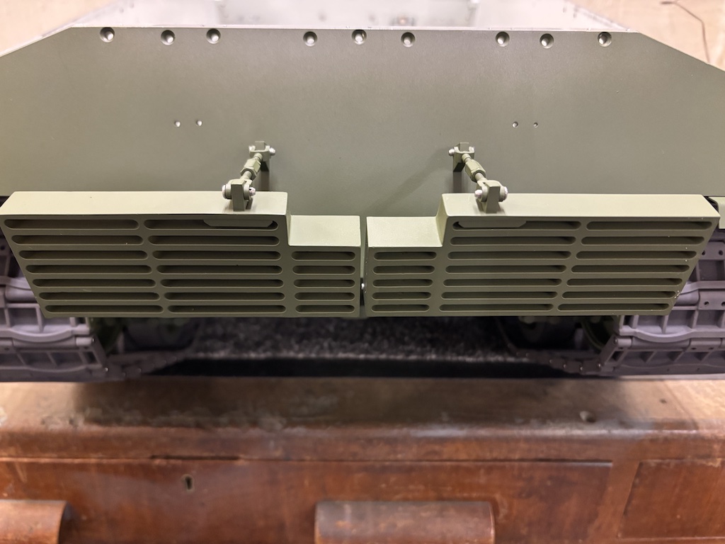

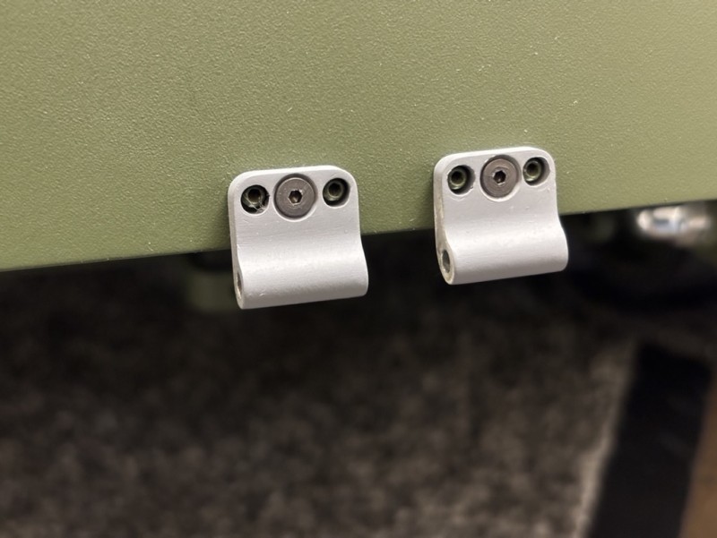

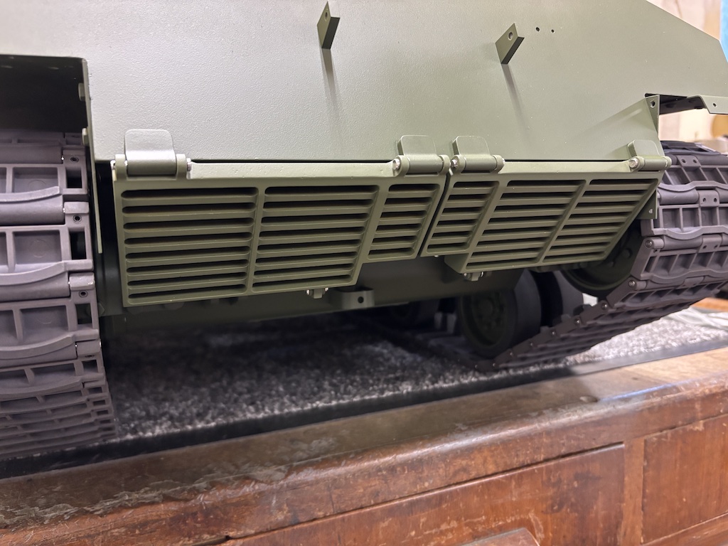

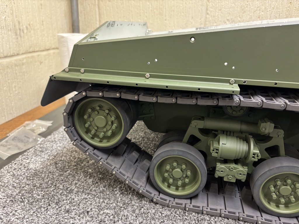

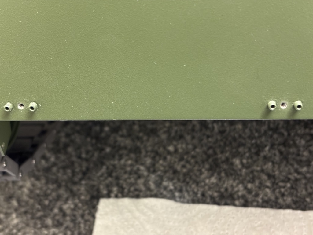

Little bit of progress.

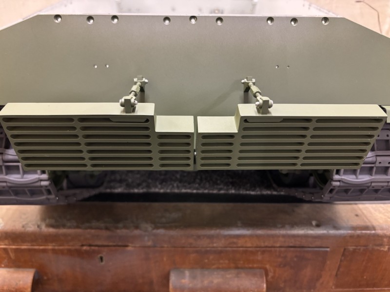

Rear grill hinges going on.
Lined up and ready for filling.
Filled and painted.
Filled and painted.

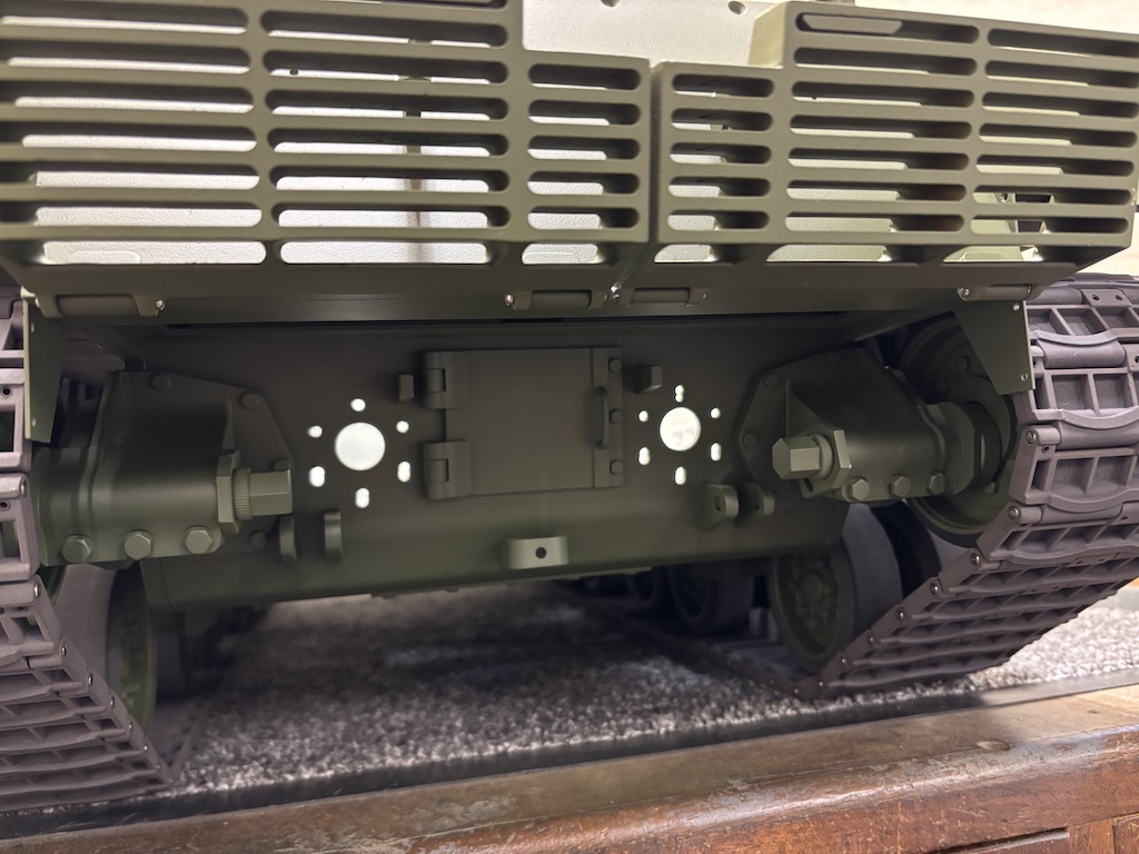

Upper brackets lined up and fitted.

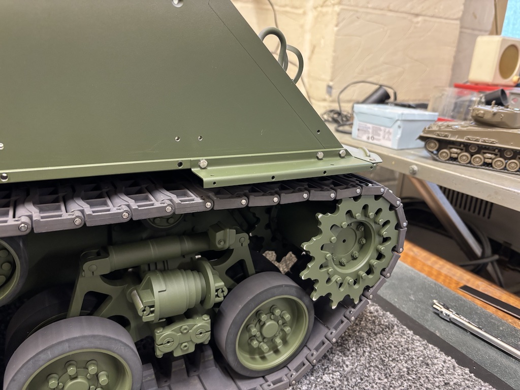

Last thing under here to do is the exhausts.

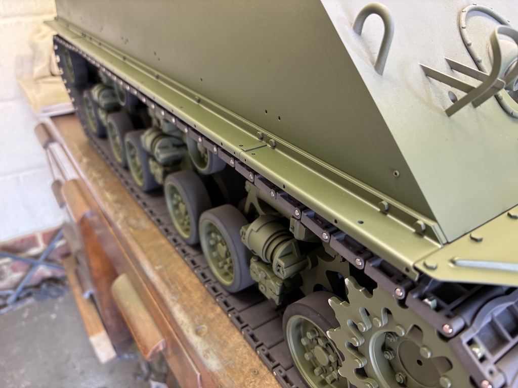

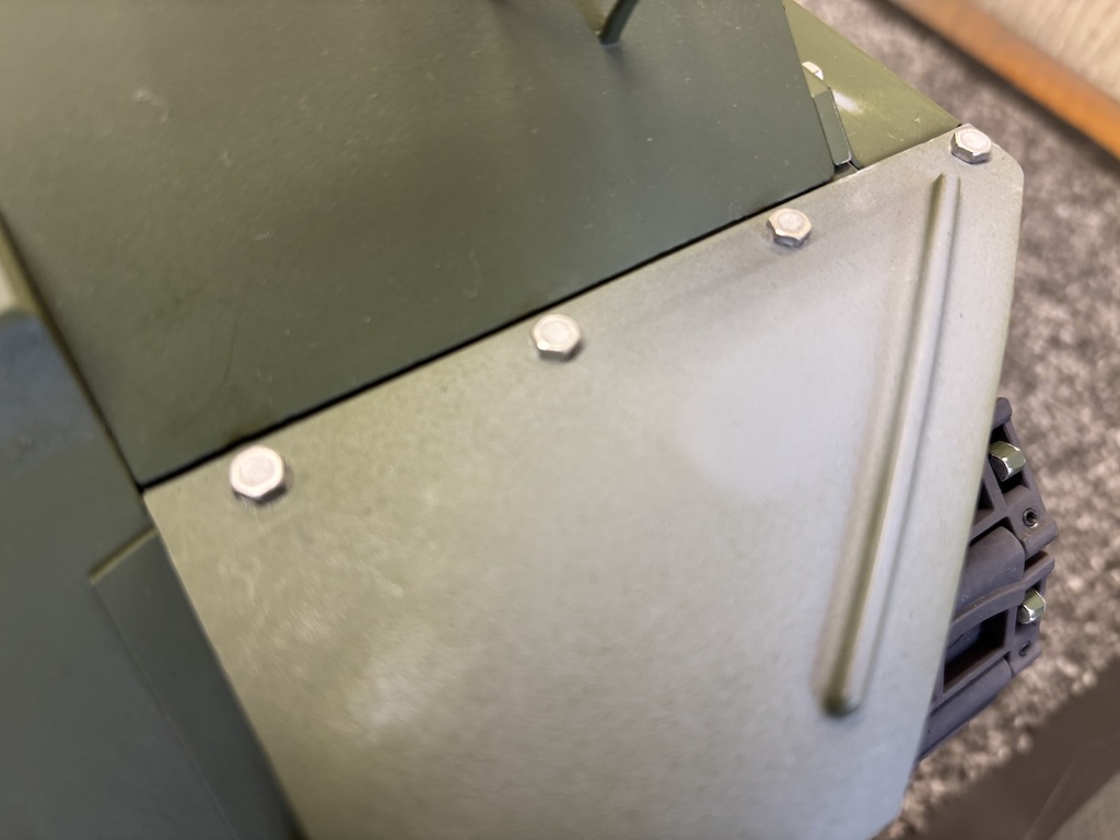

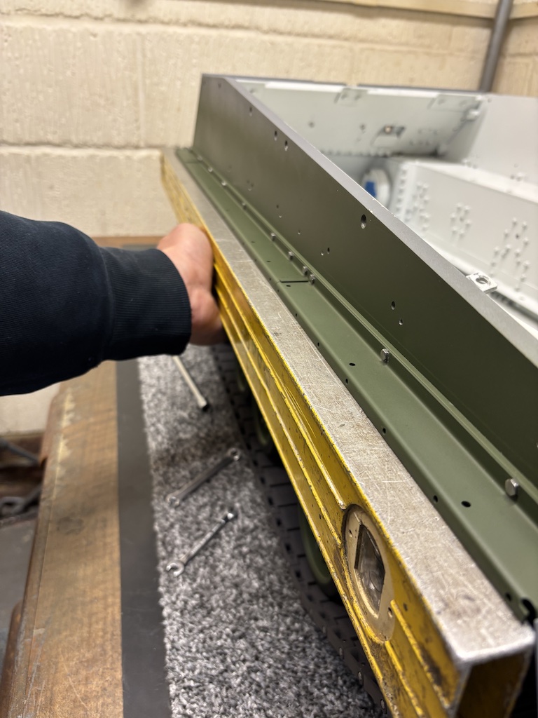

Final fitting of the side mudguards.
Checking they are nice and level.
Little skim of filler on the nuts.
Then sort out the paintwork.
That is those completed.
