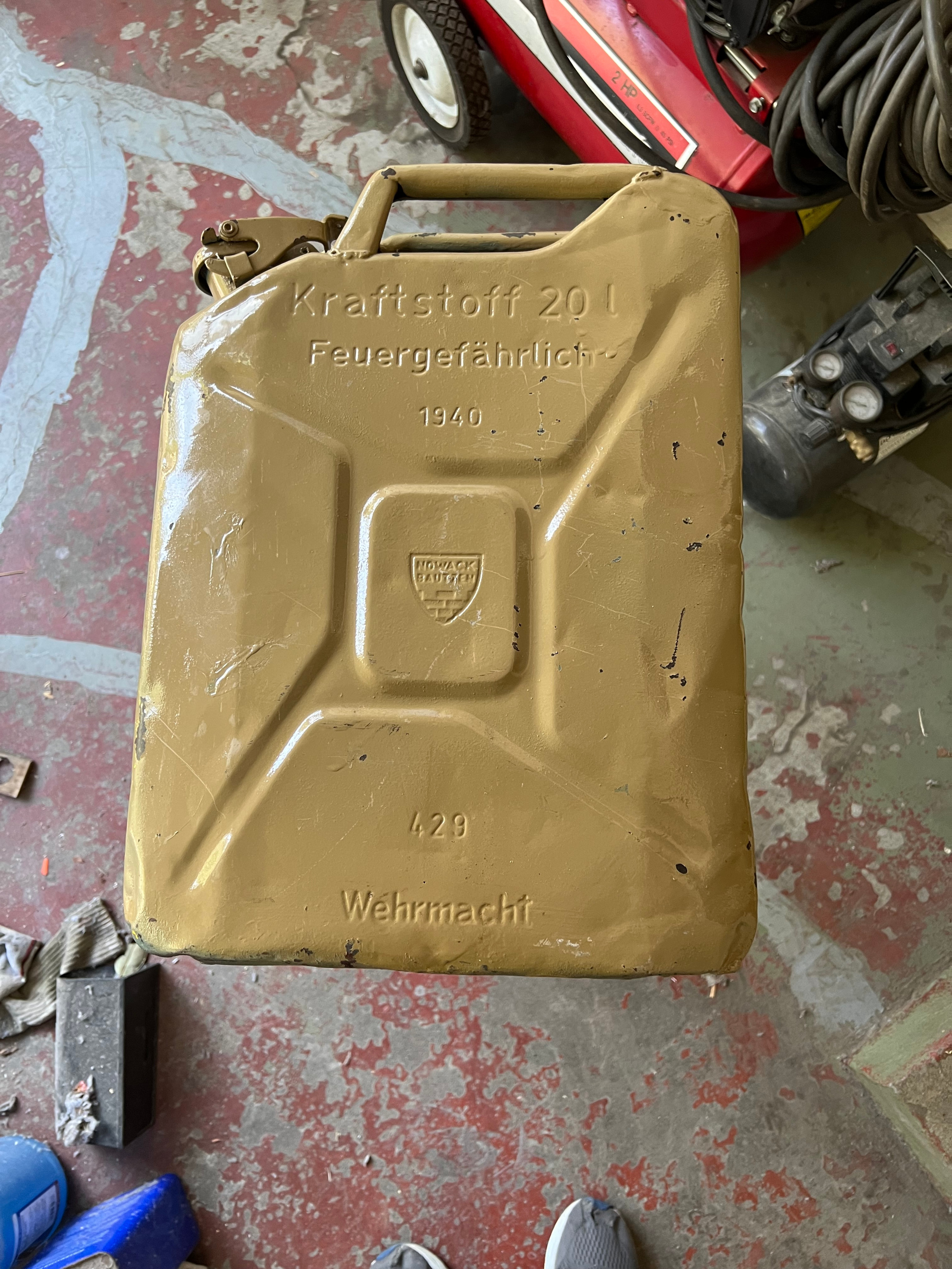

I have a 1940 vintage can but only have inch measuring tools to measure something that size. If you feel this will help
let me know what measurements you need.

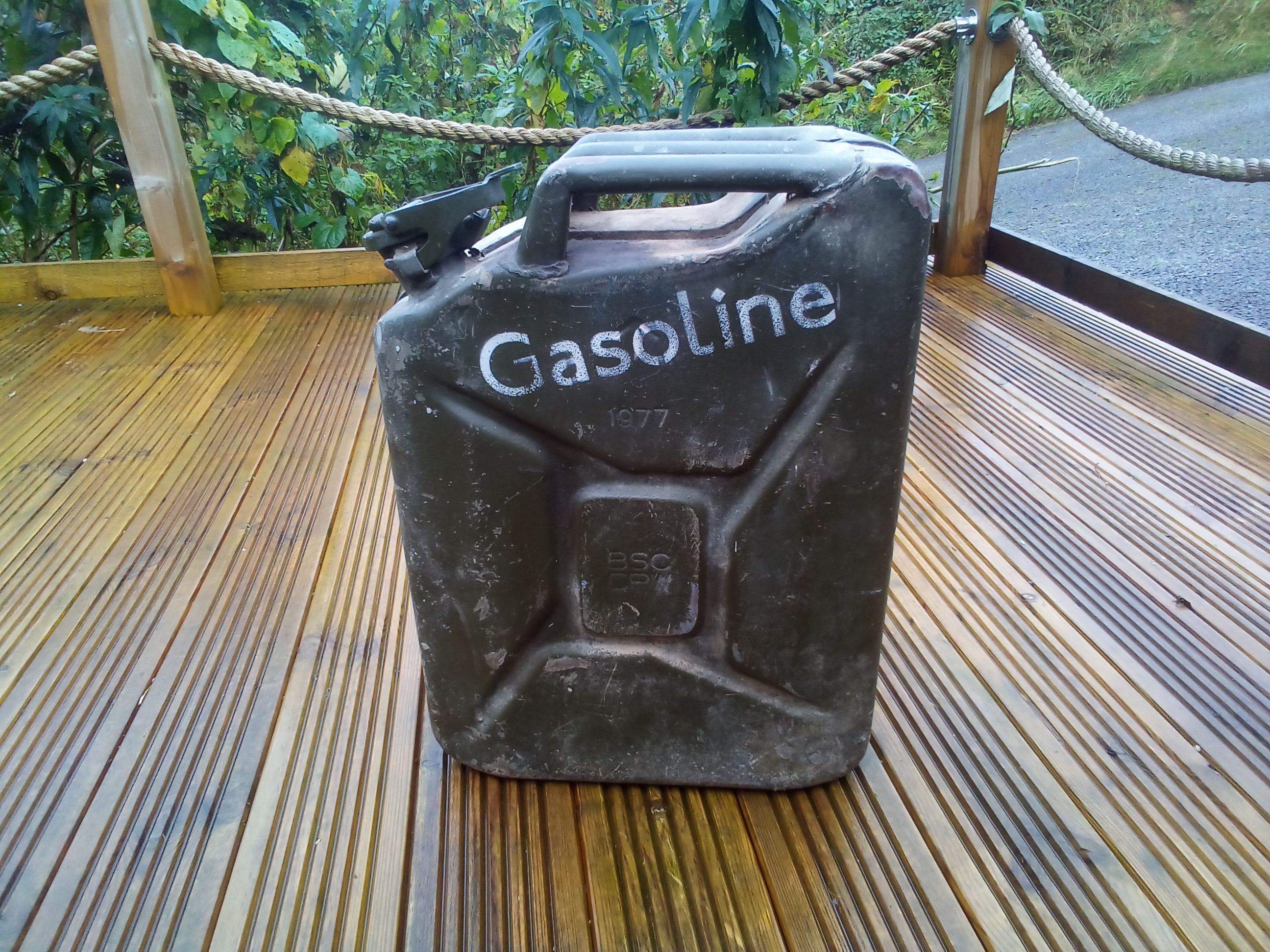

The oldest I have is From 1977, the tooling must have been the same as Mike's dimensions are correct. It's all down to the 20L volume I suppose.

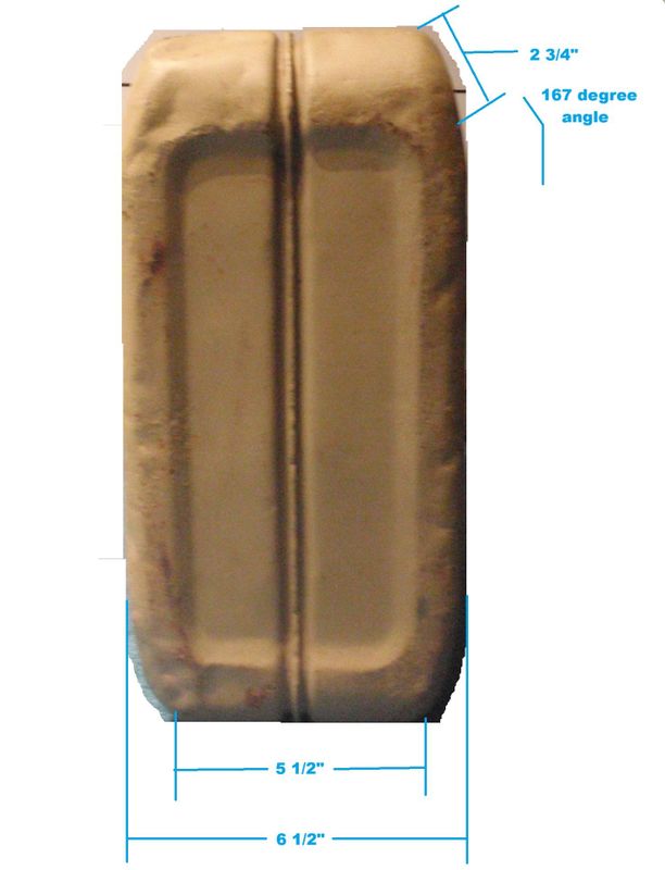

Re: Jerrycan Dimensions
Thanks guys for the help.
At least now that the depth has been measured as 6.5 inches I am happy that it is correct. There where places on the internet which were saying 5.5 inches deep.

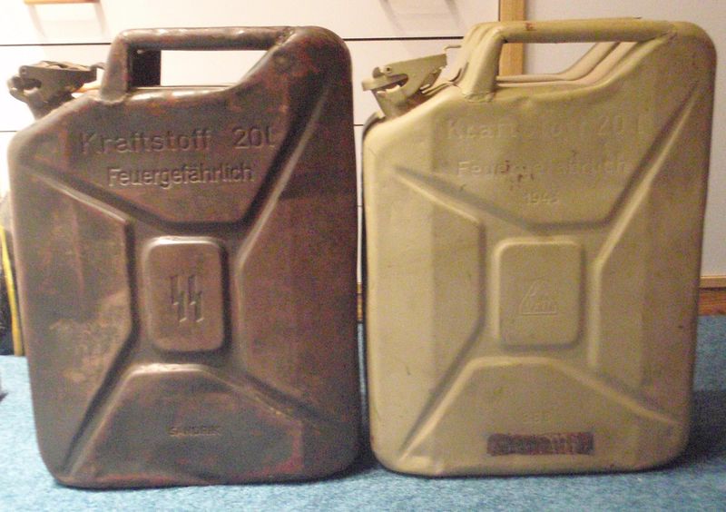

It is 5.5" at the sides and 6.5" in the middle - see picture below
This is a view of the bottom.
There is an angle of 167 degrees measured from the front to the side.
There is also a difference in the center area from the SS can to the Wehrmacht can.
SS size is 2 3/4" X 4 1/4"
Wehrmacht size is 3" X 4"
If you can get a Dragon jerry can they did a very good job with them, they just forgot
to add the recess on the bottom.

Apologies, since I posted the photo of the gas can I'd become sidetracked with other matters.
It seems the others have provided good data.
