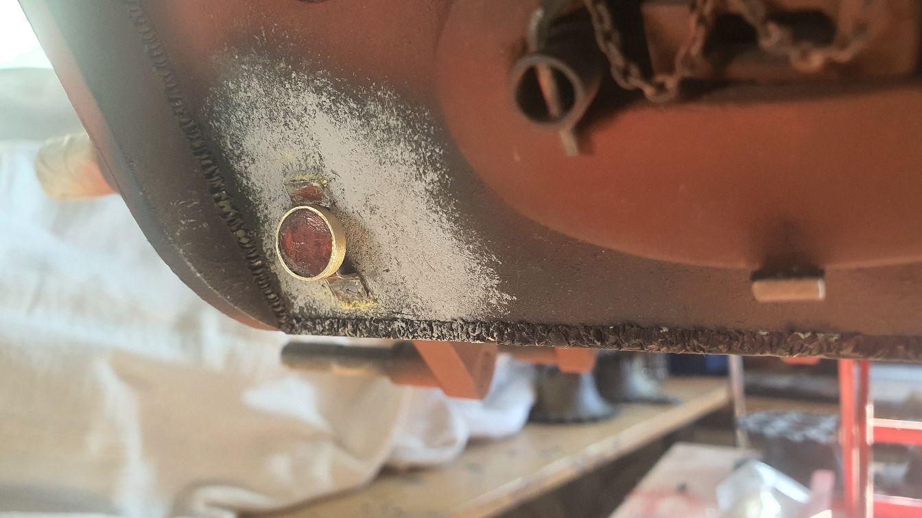

Some work on the rear reflector, reflector started off as a SW part, this was reduced to what you see, bracket was made to mount.

Fitted the reflector... looked to big! modified as pictured .
