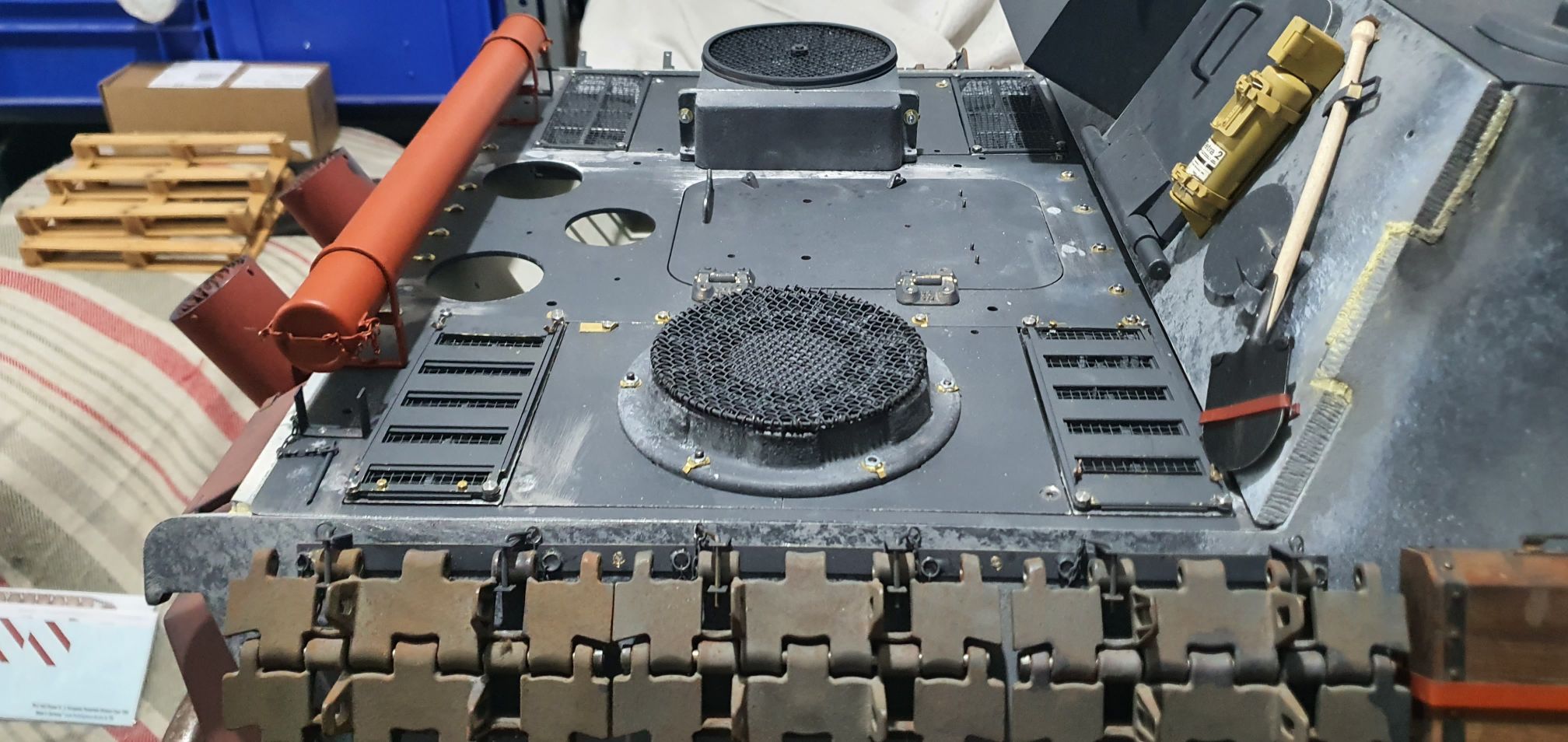

The rear deck was the last piece to disassemble and clean, the usual rust and thick paint kept me busy.
Steel deck after a good few hours back in a primer
Grills got the cast texture and (Small grills) modified
Line cut in to simulate two pcs section
Assemble with 8ba fasteners and Mike stannard lock taps, some bolts that hold the cast grills in place have been countersunk (these will be filled later) to achieve closer to the real tank bolt configuration
Steve Winstone gun cleaning tube and Mike's Grills temporarily placed to get an idea of how its going to look.

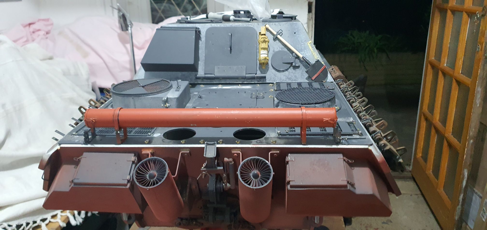

Small job today, added some fasteners to the forward section of the deck
The front mudguards are slightly to long /should be level with the vertical edge ...a fare amount of work to correct as bolts (outside edge) will also need realignment/ holes soldered up ....is it worth doing?

Front mudguard modified, thanks for the advice Steve Tillett.
Around 8mm cut away from the front, fasteners repositioned
Looking much improved
Modification went smoth except for the Small cut out section ( I cut this incorrectly) had to build it back up with silver solder.

That's other side completed...check a few times and then cut.

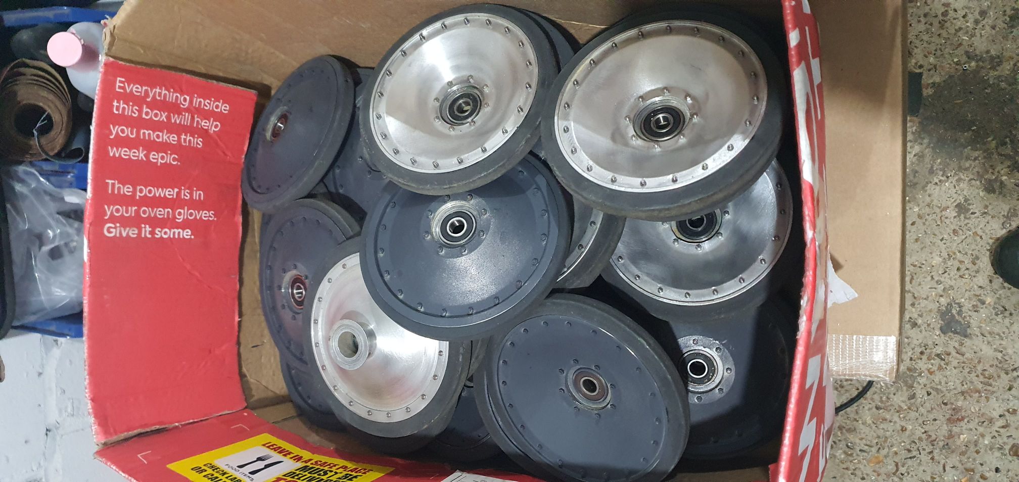

Been busy the last few days, tyres cleaned and refitted, along with bearings, just a few wheels to add the fasteners to finish.
The amount of work it's taken to bring this Jagdpanther back to this stage is emence (I wiill not take on another refurb) just my tiger 1 late to finish (this was also a full strip down) and a sturmtiger! thankfully the sturm was a bare metal build.

Refurbs are two jobs, take it apart, like restoring an old car, but can be satisfying, keep at it Dave, only four more to doo, regards Simon.

Agreed, a refurb done right is a BIG job..... The cleaning and removal of old finishes can take ages. But remember ,..... " The power is in your oven gloves ! " Love the slogan on the box..... :D :P " Epic Week......
